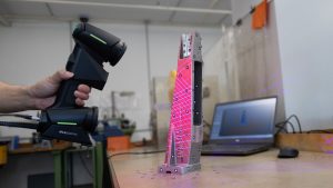

Once all the parts have been machined, the complete mould is assembled. A further check is then performed to make sure all the parts are in the correct position. Indeed, assembling a large number of parts can lead to multiple defects that can in turn result in significant dimensional variations. Since deviations in form must not exceed 0.1 mm, very precise measurement of the mould is performed using the Kreon Skyline Eyes 3D scanner. This allows the assembly to be closely compared with the theoretical model of the mould and the cast part. If defects are found, corrective measures can be taken to ensure the conformity of the tool. The parts to be measured are approximately 80 cm by 80 cm, which poses no problem for the Kreon measuring arm and its measuring volume of 2.5 m.
