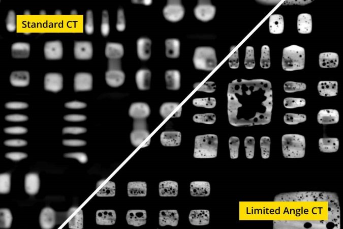

Superior Resolution: Achieves smaller voxel resolution for samples with high aspect ratios or complex geometries, where traditional geometric magnification would be limited.
Optimized Reconstruction: Nikon’s proprietary algorithm delivers datasets without quality or accuracy loss, despite reduced rotation angles, matching conventional CT performance.
