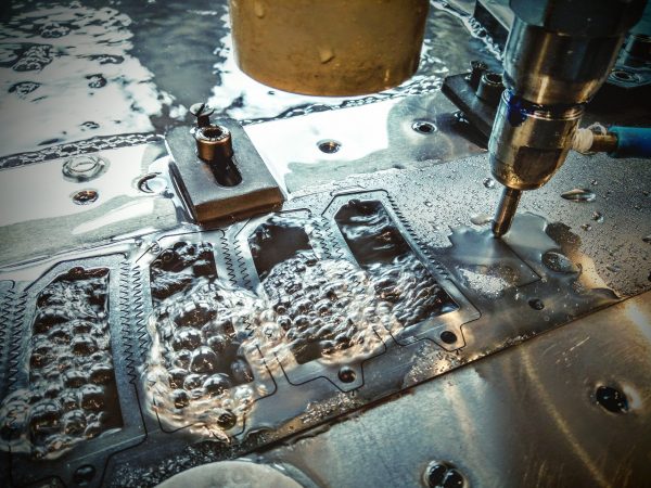

WatAJet operates in a specialised production niche. With water jets measuring 0.2 mm in diameter, high pressures and ultra-fine abrasives, the company is able to cut extremely hard or extremely delicate materials without altering them. Special steels, titanium, ceramics, multilayer composite materials, engineering plastics and glass are just some of the materials that WatAJet can process, guaranteeing exceptionally tight tolerances on even very small parts. Sectors such as biomedical, aerospace and scientific research require faultless components, as the slightest imperfection can compromise the entire product.
Micro waterjet cutting is a unique technology. Unlike laser or electroerosion, it does not thermally alter the material and allows any surface to be processed, even composites or layered materials with different mechanical characteristics. “We cut materials that are impossible for others,” explains Arleo. “In some cases, a tolerance of two microns is required on thicknesses of half a millimetre. And everything must be repeatable.” Each component requires care not only in terms of dimensions but also aesthetics, because many parts intended for biomedical use must be flawless both technically and visually.

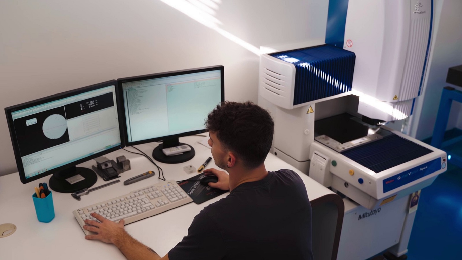

Mitutoyo’s machine has revolutionised quality control management. The main advantage is the ability to combine three technologies in a single system. High-resolution optical vision allows two-dimensional components and micro-profiles to be measured; the contact probe allows three-dimensional elements or cylindrical surfaces to be measured; the laser acquires profiles and height measurements with extremely high precision. All within a single, fully programmable cycle, just like a numerically controlled machine tool.
“With three technologies in a single machine, we can measure any part that comes out of production,” explains Arleo. “If we hadn’t chosen the Quick Vision Apex, we would have had to purchase three different instruments. Here, everything is integrated and can be automated.” The ability to program complete measurement cycles and let the machine operate autonomously has allowed WatAJet to manage even very large batches while maintaining consistent precision and ensuring full data traceability.
Every day, Quick Vision Apex starts up at the beginning of the shift and works for hours without interruption. It is no longer just a measuring tool: it has become an integral part of the production flow. Automatically generated reports, structured management of measurement cycles, and the ability to repeat complex checks without errors make metrology an ally of production, rather than a separate and potentially critical step. This level of automation has enabled WatAJet to satisfy customers with stringent requirements, comply with complex control plans, and focus on its technological growth by reducing repetitive manual tasks.
Quick Vision Apex has also paved the way for machining and checks that were once very difficult to manage. Particularly complex three-dimensional components, deep micro-holes, intricate profiles on extremely hard materials: everything can be measured with precision and repeatability. “It has become a production machine, not just a measuring tool,” emphasises Arleo. “Program it once, it does the rest. And it is always accurate.” For a company like WatAJet, where quality is central to its offering, such reliability is an indispensable asset.
