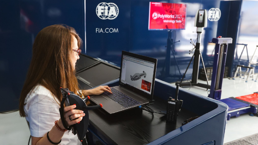

Thanks to the PolyWorks/Inspector platform, the spearhead of InnovMetric, the FIA โ€‹โ€‹has taken a big step forward in verifying the compliance of cars this season.
“Previously, the FIA โ€‹โ€‹carried out its checks using 2D templates to validate the aerodynamic shapes or limit gauges to assess the dimensions to be respected”, explains Jean-Sรฉbastien Blais, engineer and expert in the deployment of the enterprise solution at InnovMetric. “Although simple to use, these methods are expensive to maintain and must be redone each time a specification change occurs.”
โ€œUsing our software, all you need is a laptop, a small suitcase that contains a laser tracker and a person who can do the inspection on their own.ย It provides a printable inspection report available immediately after taking the measurement.”
In concrete terms, the software makes it possible to measure in three dimensions predetermined points of the single-seater.ย An operator positions a spherical reflector on precise points which are picked up by a laser tracker.ย These measurements are then sent in real time to the database and compared to a model or digital twin of the car.
