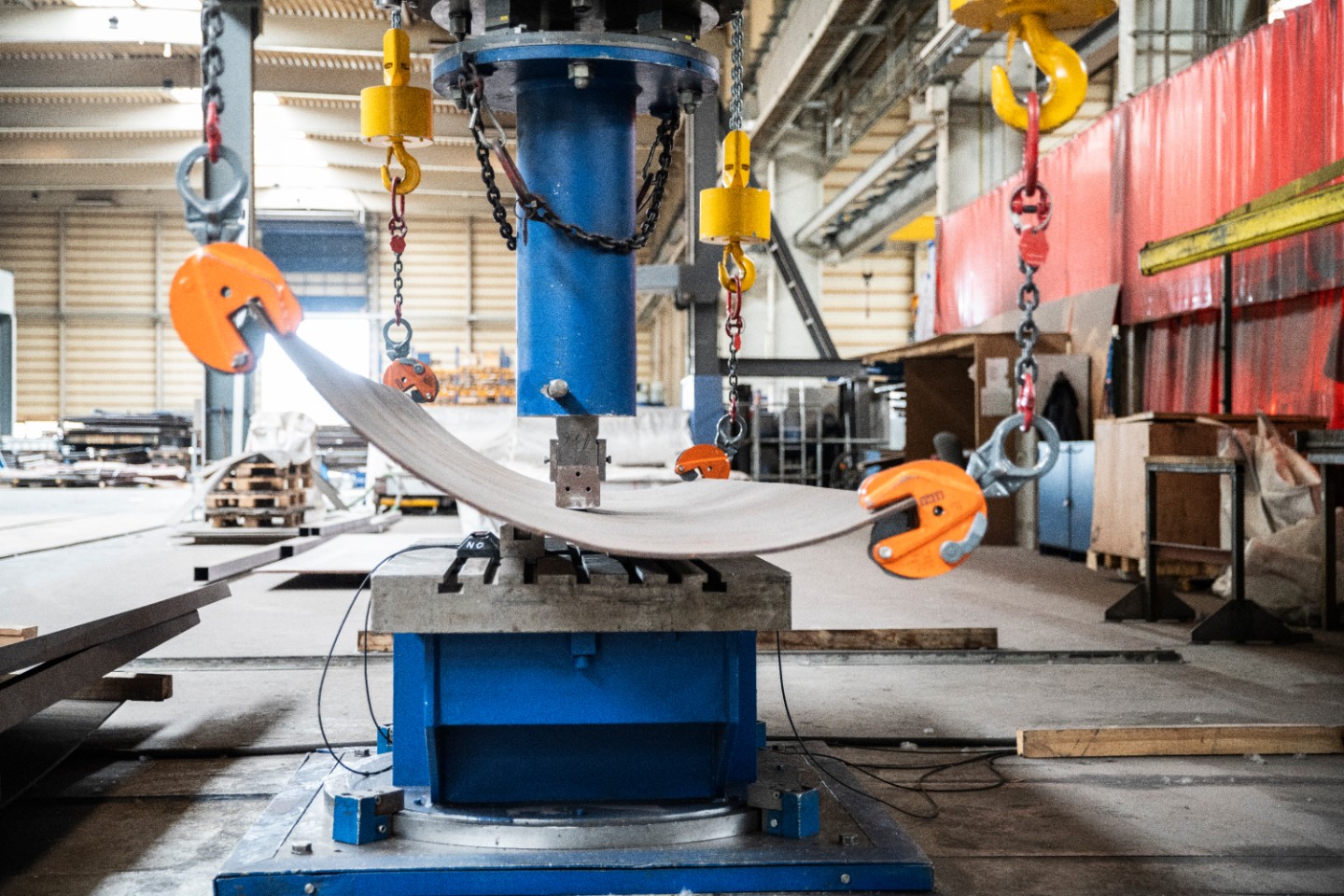

When bending steel sheets weighing several tons for ship hulls, the final geometry often depends on the trained eye and experience of the workers. Millimeters determine the accuracy of fit and stability. Until now, specialists had to repeatedly stop the production process to manually check for deviations in shape – a time-consuming and error-prone process. Conventional approaches to digitalizing these processes from industrial series production can hardly be transferred to the individual production of single pieces in shipbuilding.

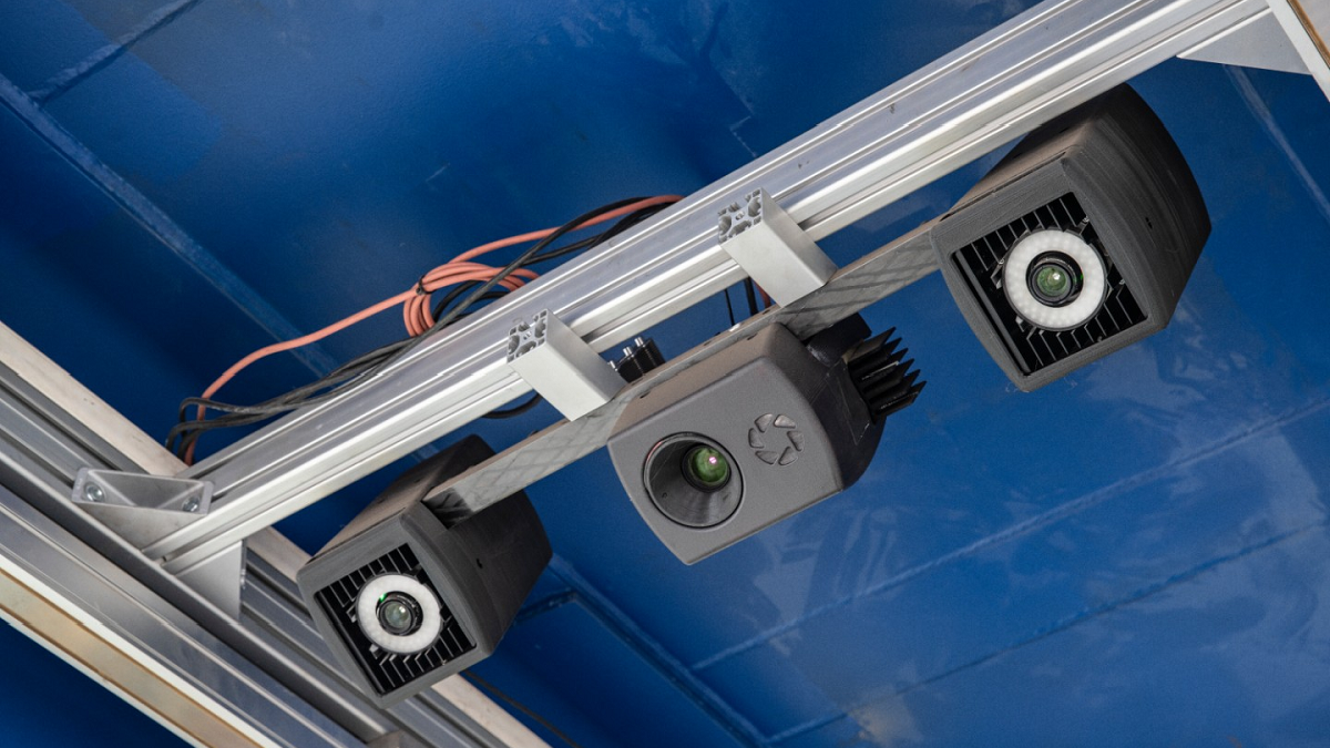

For the DIKUQ project, researchers at Fraunhofer IOF have developed a novel high-speed inline 3D measurement system: a low-latency 3D sensor network that can be used to digitally capture the workpiece, enabling precise target/actual comparisons directly at the press. The system consists of two synchronized cameras on the right and left sides of the workpiece, which are coupled with the corresponding projectors. This allows a measuring volume of up to 4 x 2 x 0.5 meters to be completely captured in less than half a second. The image sequences obtained are reconstructed into a precise 3D model of the workpiece using triangulation.
3D measurement system enables real-time comparison of target and actual values during cold forming of steel plates
At the heart of the system is an area-based 3D measurement method using structured light in the near-infrared range (NIR). “An irregular pattern is projected onto the object surface, which deforms according to the geometry of the workpiece,” explains Dr. Christoph Munkelt, research scientist in the Imaging and Sensors department at Fraunhofer IOF. “The distortion of the pattern then provides us with the information for the 3D reconstruction.”
“The decisive advantage over conventional methods lies in the real-time feedback,” explains the IOF researcher. “The system creates an automated target/actual comparison with the target geometry, which is projected onto the sheet metal. This allows the worker to see immediately where reworking is required to achieve the target corridor.” Physical test templates, which would otherwise have to be time-consuming to set up and evaluate, are no longer necessary. Instead, a digital “test template” is available that can be compared with the process data at any time.

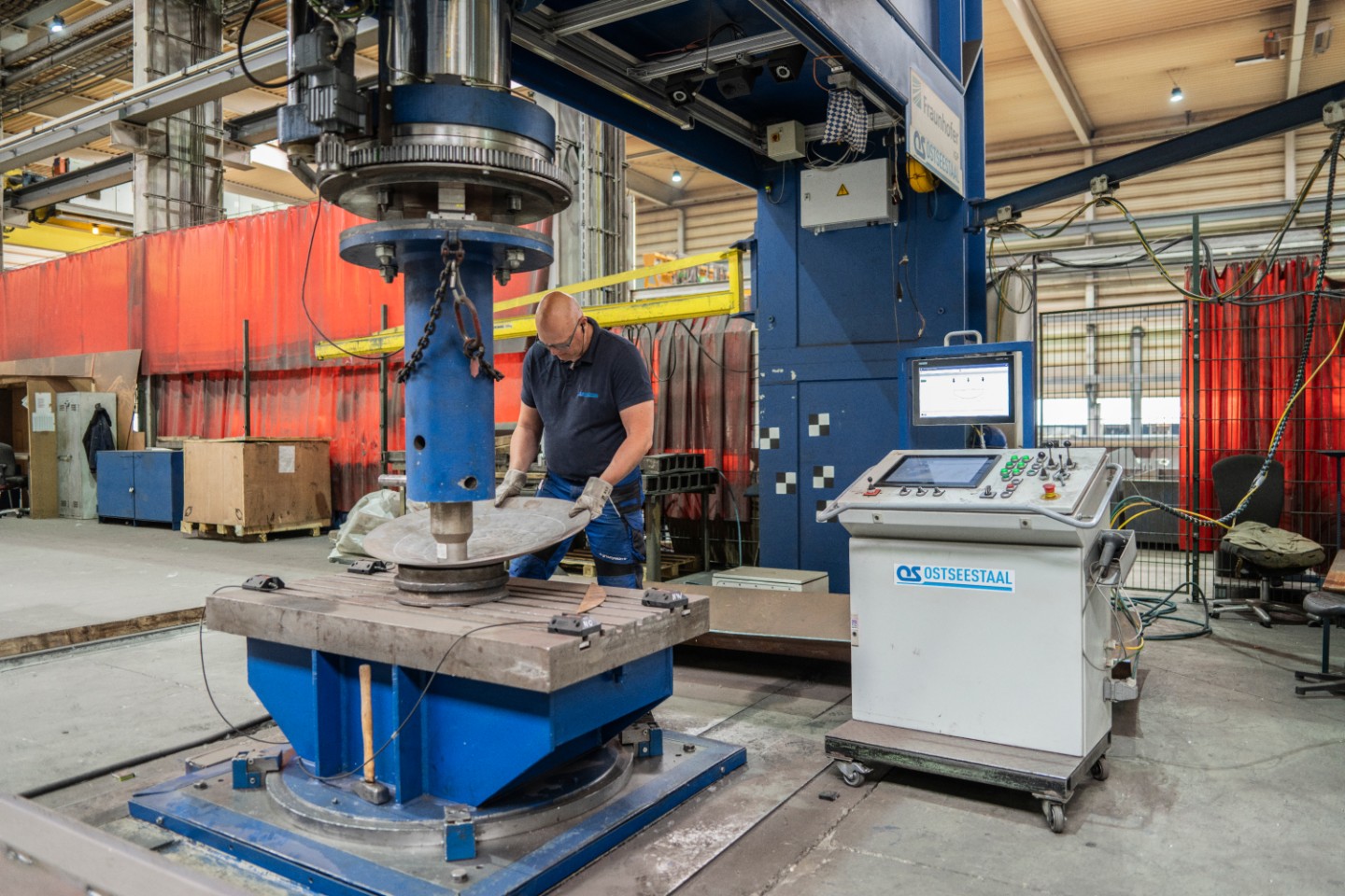

The system’s precise, digital feedback makes complex work steps that were previously anchored exclusively in the experience of workers accessible for new employees. “Our goal is to provide digital support for the forming process, which has previously been shaped primarily by the expertise of the workers. This enables us to counteract the shortage of specialists, increase process reliability, and make jobs more attractive,” explains Maximilian MĂĽller, Head of Research and Development at Ostseestaal.
Forming a steel sheet – Due to the measurement system test templates are no longer required during forming
Digital recording of the workpiece geometry minimizes quality fluctuations, achieves higher fitting accuracy, and reduces the return rate. At the same time, the system creates complete quality control documentation that is traceable for end customers.
