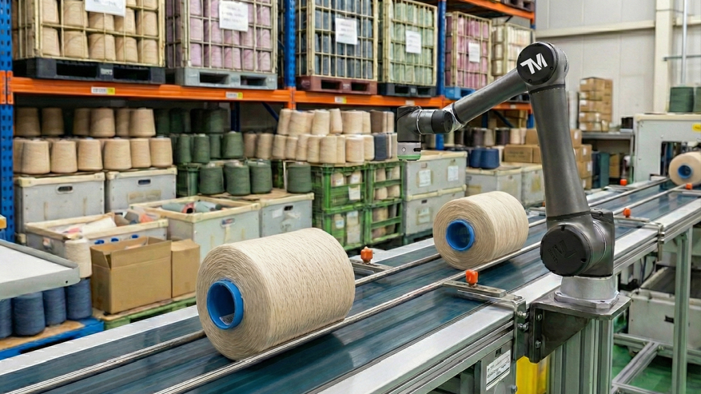

Robotic Vision Inspection
To address these challenges, a Proof of Concept was established using Techman Robot’s AI capabilities integrated with high-end vision hardware. The inspection setup included:
Vision Hardware: A Basler acA2500-14gm camera paired with an OPTART 25mm fixed focus lens and a CCS LDR2-50SW2-JD light source.
Configuration: The system was set up with an object distance of 30cm, capturing images of the sides of the yarn rolls.
Mechanism Strategy: To solve the focus issues caused by the roll’s curvature, the evaluation concluded that a rotating mechanism is necessary to bring defects into the focal plane for accurate detection.
