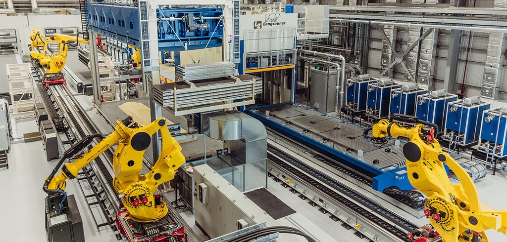

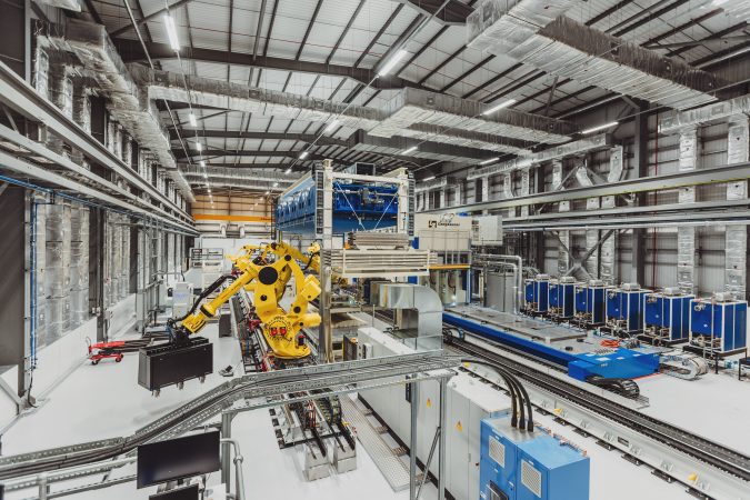

The unprecedented scale of the facility centers around Langzauner’s Resin Transfer Moulding (RTM) press – the world’s largest for integral aerostructural parts – boasting a 2,400-tonne pressing force and a tool size of up to 10m x 3m.

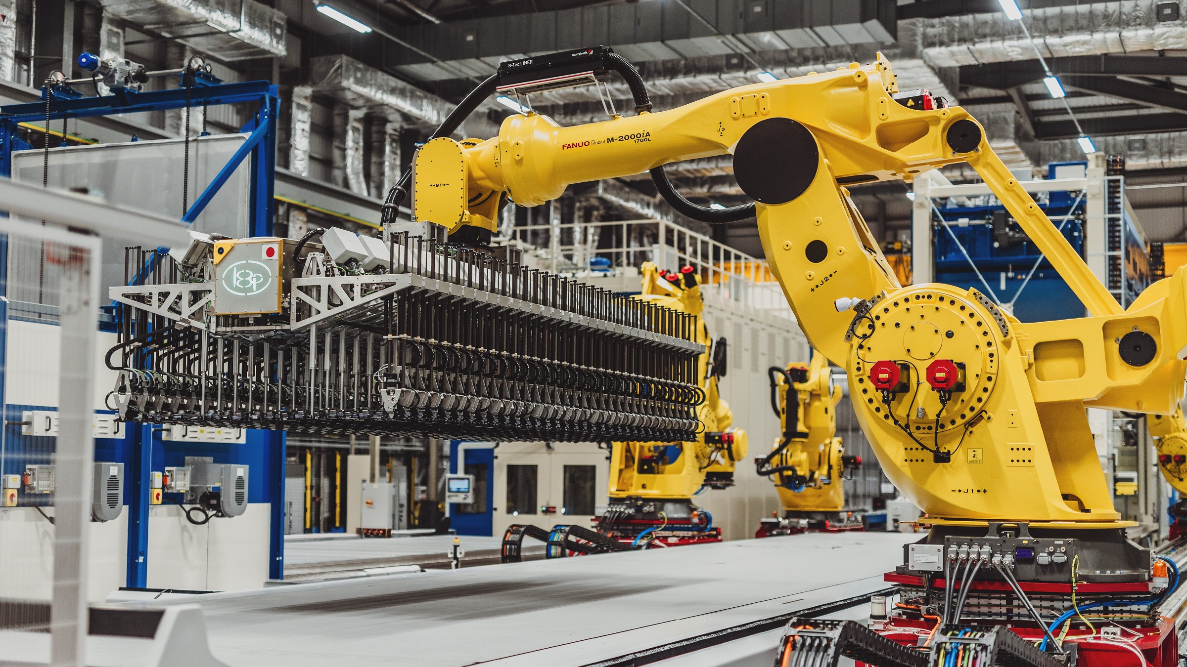

Operating adjacent to a 21.4m Zünd cutting table, the cell features an automated FibreLINE deposition system developed by Loop Technology. Here, two 5-metre FibreFORM grippers handle the delicate material, mounted on two of FANUC’s largest industrial robots and supported by three additional FANUC robots. This five-robot fleet operates along an 85m track, leveraging real-time sensor data to dynamically adjust to material behavior during the high-rate build process.
