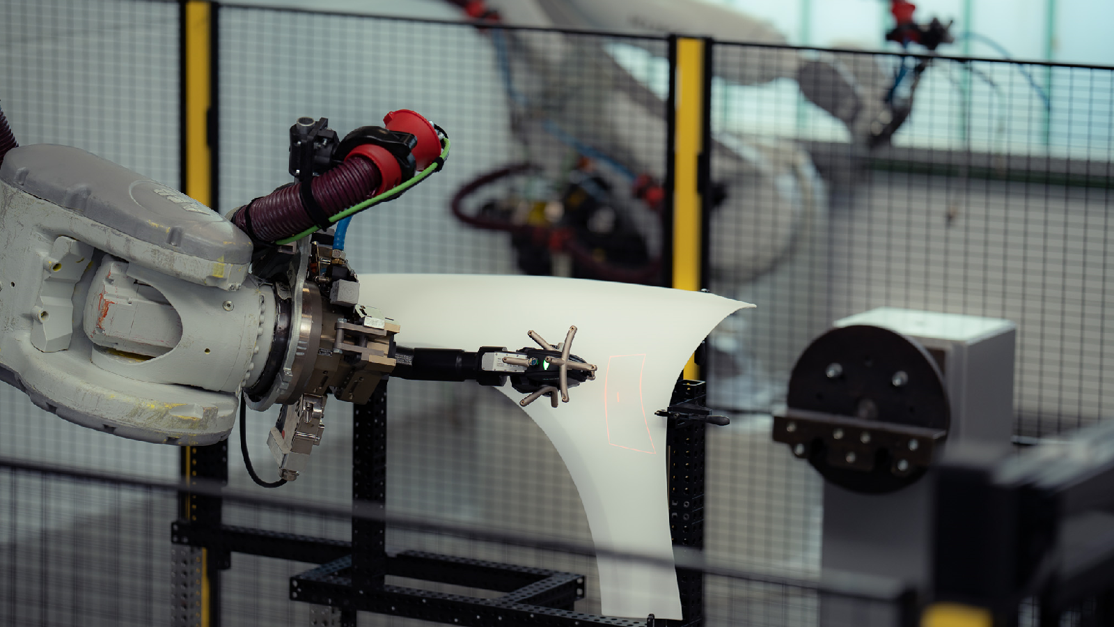

Solution: NEXOS 4.0 and Automated Measurement Cell
Eleven Dynamics GmbH stepped in with a solution. They implemented NEXOS 4.0, a software that could fully control the measurement cell within just three days. The solution was capable of simulating and managing automated measurement processes in a digital twin, making it the only solution that worked automated for KaKue.
The solution was flexible and adaptable, designed to meet KaKue’s specific needs. It could support any robot, sensor, and cell configuration, making it a perfect fit for the diverse range of tasks in their measurement services.
Based on the successful implementation of NEXOS 4.0, an automated measurement cell, consisting of the Leica Absolute Tracker AT960 and the Absolute Scanner AS1, was installed at KaKue.
