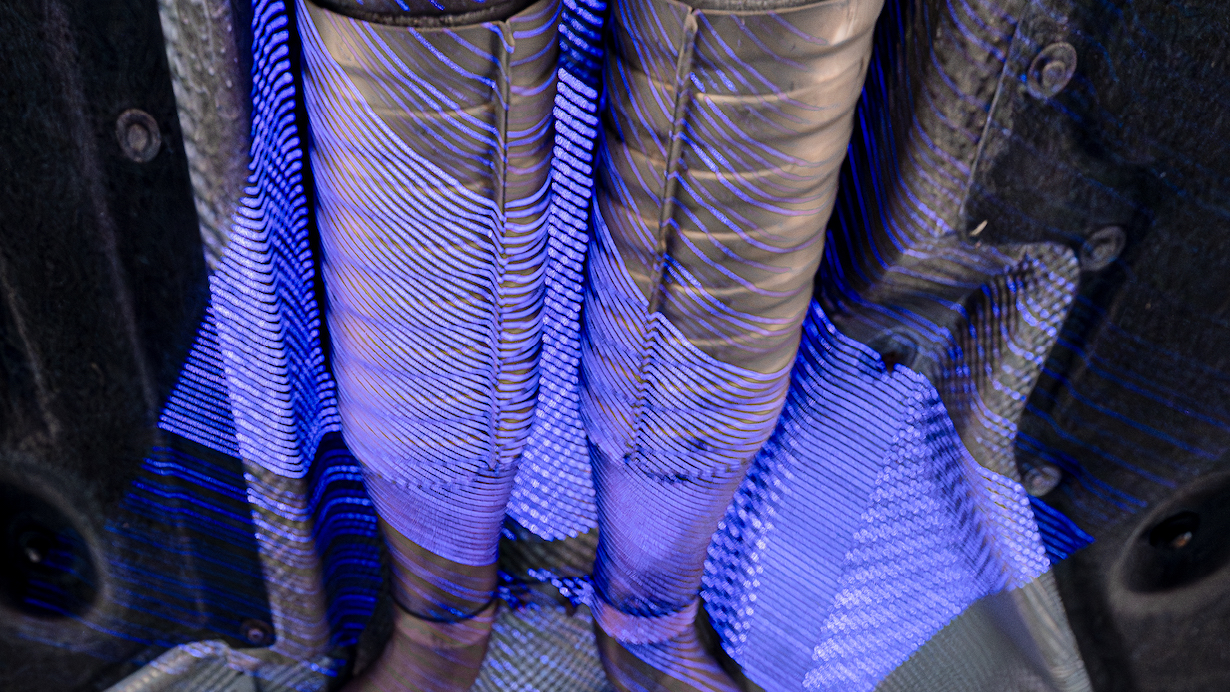

The FreeScan Trio presents a notable development in laser 3D scanning technology, offering marker-free scanning capabilities facilitated by a 98-laser-line mode and a triple, 5MP camera system. Not only but especially for projects involving large objects, scanning without the need for markers significantly reduces preparation time. Moreover, the scanner is able to capture an impressive 3,010,000 points per second, establishing it as the fastest handheld 3D scanner in its class. Complemented by a large field of view of 650 by 580mm, it captures more data in fewer sweeps.
Ninety Eight Laser Lines
In addition to the 98-laser-line mode, the FreeScan Trio offers a single-line mode, one with 7 parallel lines, and one with 26 crossed lines. These modes can tackle many different projects in all kinds of industries, conferring the scanner with the versatility that is now customary in all SHINING 3D products. With markers, these modes all achieve an accuracy of up to 0.02mm, and a volumetric accuracy of up to 0.02 mm + 0.03mm/m.
