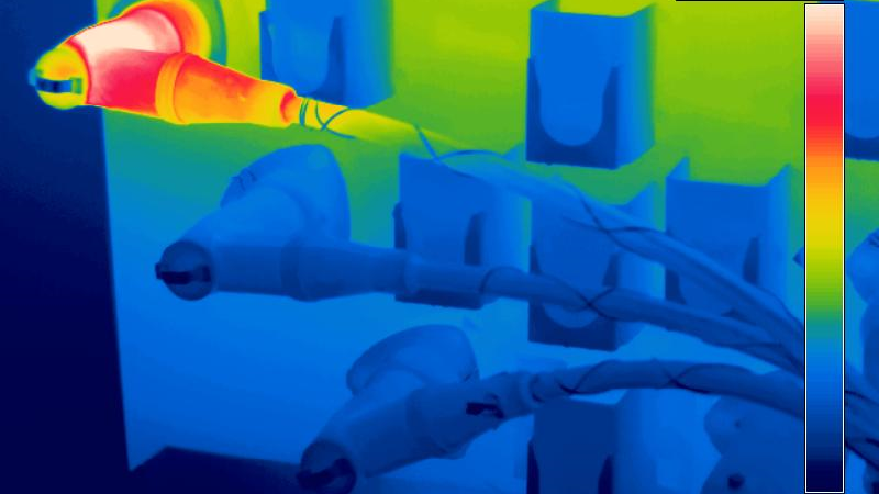

Other examples might be electrical connections, fuse boxes, contactor plates, or other components found in electrical cabinets. Over time, tiny vibrations and heat cycles can cause crimped connections to loosen, along with nuts and bolts on connective wiring which give rise to elevated temperature as the electrical resistance increases. This type of common fault has no visual clues and can happen at any time during the production process, yet in most cases can be prevented using predictive condition monitoring techniques.
Thermal Imaging Cameras – Key In Reducing Unscheduled Downtime
If regular thermal inspections are undertaken, thermal signatures can be identified for every electrical connection, electric motor, other electric component or moving equipment in a facility. While equipment operates as intended, temperatures will remain reasonably consistent, and the insights gained will be no more than regular reassurance. However, if suddenly a temperature reading begins to unusually increase, then this may be indicative of a developing fault.
As mentioned earlier in this article, correcting faults may be as simple as tightening a connection or cleaning cooling fins or air-ways – but faults may be more severe and require more detailed maintenance or component replacement.
