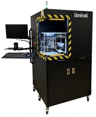

Liminal’s EchoStat ARRAY Ultrasonic inspection system for inline testing

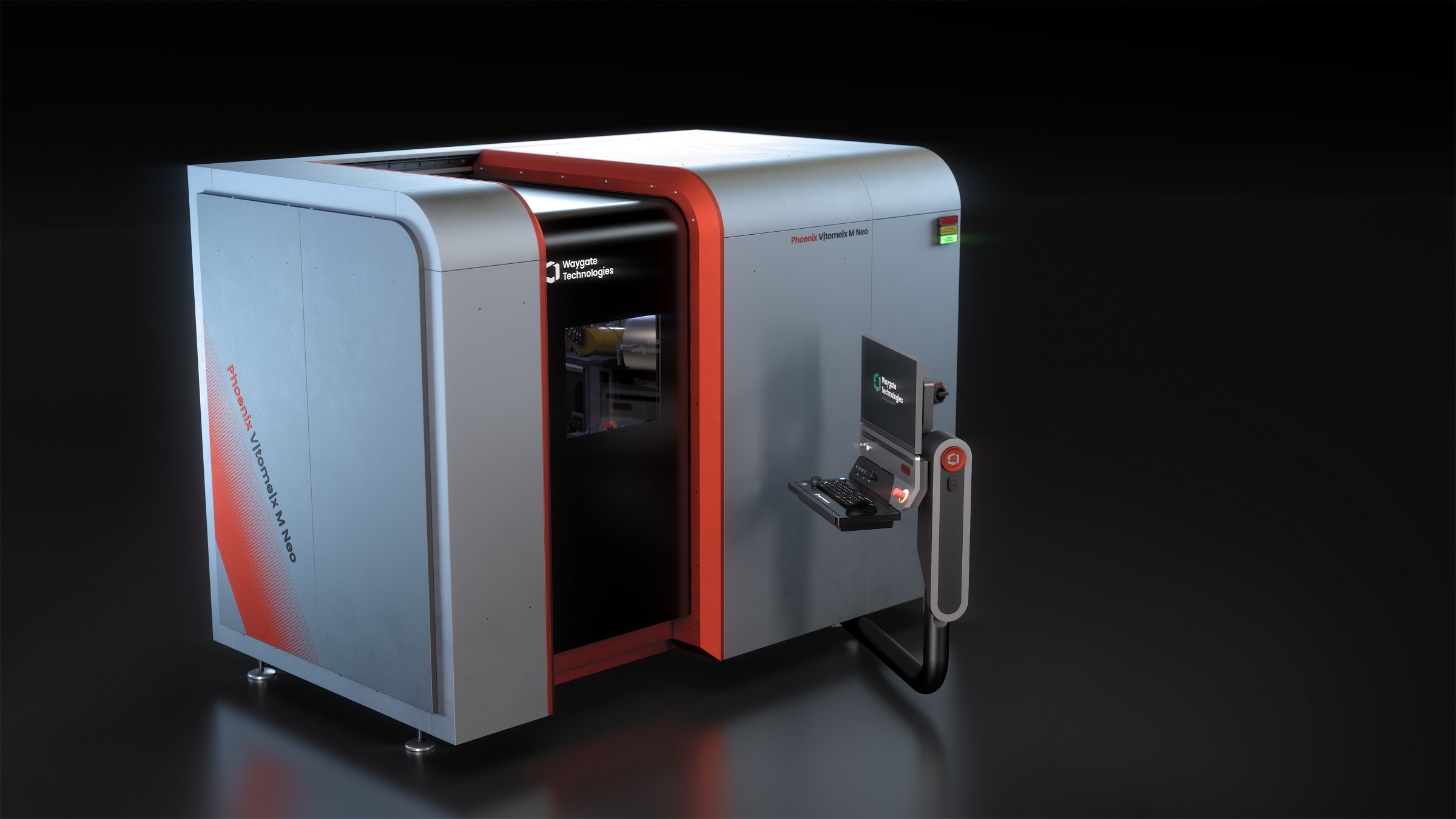

By bringing together the industrial computed tomography (CT) and radiography leadership of Waygate Technologies with Liminal’s real-time ultrasound AI analytics, the two companies will be able to offer a full-lifecycle inspection capability spanning cell production through to module assembly and field service.
For radiography and CT, the collaboration leverages CT systems from Waygate Technologies for quality assurance and failure analysis in laboratory environments, R&D-grade nano CT for cell development and materials characterization, and high energy CT for battery pack and module level inspection. The Waygate Technologies Krautkrämer product line adds ultrasound solutions from phased array electronics to advanced beam-forming algorithms and probes designed and purpose-built in house for industrial environments. Co-development with Liminal will combine the company’s proprietary array probe technology and signal processing electronics with Liminal’s EchoStat hardware platforms and AI analytics layer, creating a next-generation inline ultrasonic testing (UT) platform with superior sensitivity and production-line robustness.
Manufacturers Will Gain Earlier Defect Intervention
Through the combination of multiple NDT modalities – X-ray CT as ground truth, ultrasound for inline screening, and machine learning to close the feedback loop with process data – manufacturers will gain earlier defect intervention, reduced end-of-line scrap, and data-driven process optimization.
