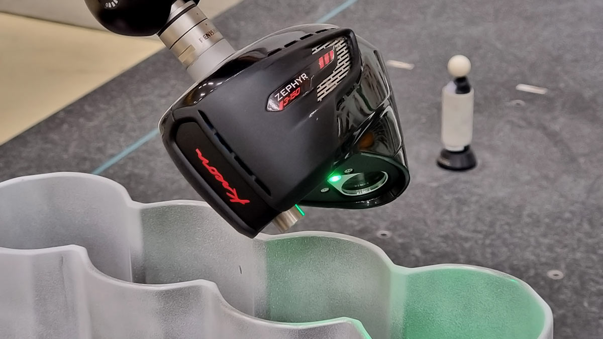

Therefore the metrology team looked for other alternatives to directly digitize on CMMs. This led them to discover Kreon 3D scanners, particularly the Zephyr III. The feasibility of integrating the Zephyr III into the measurement process was quickly demonstrated by Kreon experts. The Kreon solution offers several advantages, including the compatibility of Zephyr III with Metrolog X4, the metrology software of the Stellantis group. The teams were also attracted by the efficiency of Kreon experts and the company’s geographic proximity.
To ensure optimal operation of the solution, the implementation of the Kreon scanner required modification of the controller and replacement of the CMM rack. Two ACR III tool change racks were also installed to automate the transition from tactile probing to laser scanning. The inspection is thus continuous, using probing for checking straight faces, holes, and areas with fine tolerances, and the scanner for the overall inspection of the parts’ shape.
The inspected parts, with dimensions of up to 800 x 500 mm, are quickly digitized by the Zephyr III 150, thanks to its 150mm wide laser line. Optimization of measurement programs has also increased productivity. New scanning sequences related to scanner management have been added to existing programs, replacing the old probing sequences. This evolution saves time, as it was not necessary  to recreate programs entirely.
Despite regular changes in part indices, the scanner trajectory programming does not need to be redefined each time. Significant time savings are facilitated by the seamless integration of Zephyr III into Metrolog X4.
The inspection is now fully automated, and a single operator can handle two CMMs simultaneously.
The defects sought on the parts are specific to the manufacturing processes present in the company, namely electroerosion and machining. Wear of the electrodes of electroerosion machines can leave marks on the part, while machining can reveal milling cutter marks and steps. Some mixed assemblies that use both machining and electroerosion can sometimes show fitting defects between parts manufactured by the two different techniques. In general, the shape deviations sought with the scanner are 0.25mm.
