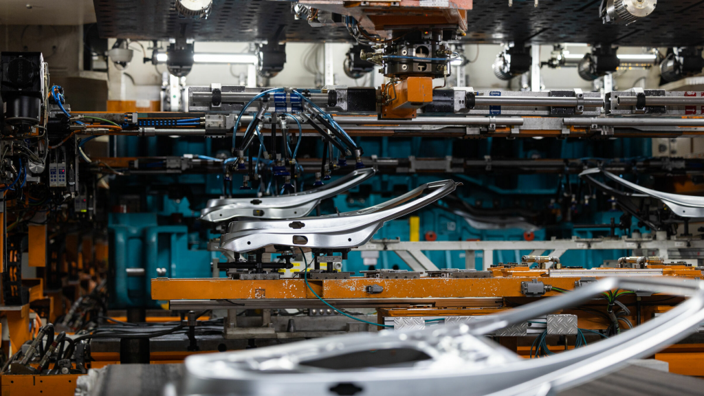

Audi uses artificial intelligence and machine learning. At the Ingolstadt press shop, an AI algorithm helps detect cracks in components.
Artificial intelligence and machine learning are core technologies in Audi’s digital transformation and modern production. An AI algorithm in the Ingolstadt press shop helps identify flaws in components. That procedure is supported by software based on an artificial neural network. The software itself identifies the smallest flaws and reliably marks them. The solution is based on deep learning, a special kind of machine learning that can work with unstructured and high-dimensional data volumes. The team used several million test patterns to train the artificial neural network over months. That database comprises several terabytes of these images from presses at Audi sites and several Volkswagen sites.
In another pilot project, Audi uses artificial intelligence to check the quality of spot welds in high-volume production at its Neckarsulm site. It takes about 5,300 weld spots to connect the components in the body of an Audi A6 with one another. Until now, production staff have used randomized ultrasound analyses to monitor the quality of resistance spot welding (abbreviated WPS in German). As part of the WPS Analytics pilot project, experts use artificial intelligence (AI) to detect quality anomalies automatically in real-time. Currently, the algorithm, dashboard, and deep quality analysis application are all used to construct the body of the A6 and A7. It is a blueprint for other applications in networked production.
