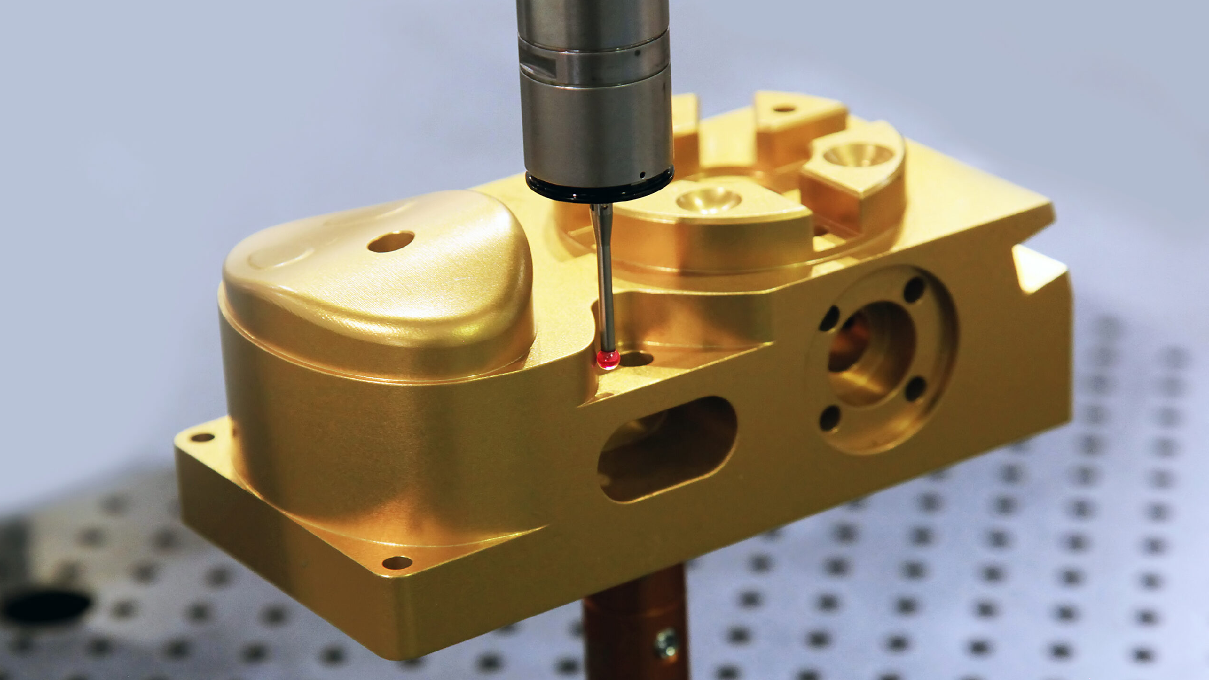

In order for an artificial neural network (ANN) to be trained for quality prediction, quality control data must also be recorded in addition to the production data. CNC-controlled measuring machines in particular offer great potential: They record measurement data automatically and with high repeatability and make them available for further use. However, data from analog measuring equipment can also be used for predictive quality. The quality of the measuring equipment used determines the maximum achievable accuracy of the quality prediction.
