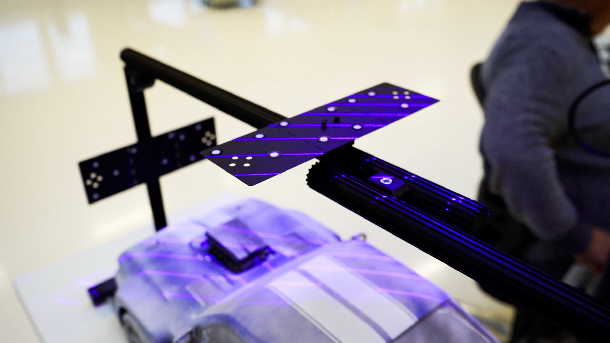

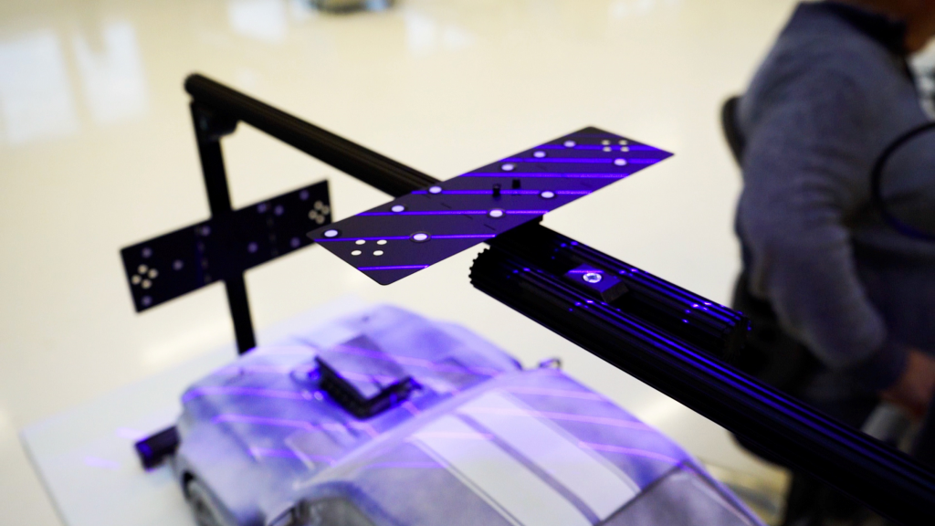

Modular Measuring Frame Provides Fast, Flexible, Efficient 3D Scanning
The AESUB Rack is a modular measuring frame which, with just a few movements, can also be precisely positioned around large or complex parts for the purpose of optical measurements. Due to its tensioning system, the individual components can be mounted quickly and easily around the part, thereby enabling near-contour alignment.
The rack is particularly suitable for mini production runs with 2-3 objects or for large, complex parts. Reference points can be placed directly onto the frame. Modular in construction, the AESUB Rack can be modified and adapted to new requirements at any time. Elements of the AESUB Rack can be shaped or bent to bring it closer to the geometry of the component.
The measuring frame is perfect for pilot or small production runs and prototypes and can provide benefits in situations requiring ad hoc or precise measurements.
