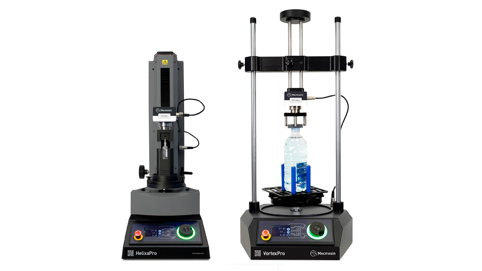

Mecmesin has announced the expansion of its range of software-controlled torque testers. The latest additions to the lineup, the VortexPro and the HelixaPro, allow torque testing up to a capacity of 30 N.m. These compact models feature a precision motor that drives the tester to a specified angle while gradually applying torque to the specimen, measured by a highly accurate ETS torque sensor. With their small footprint, the VortexPro and HelixaPro are perfect for laboratory or production environments where benchtop space is limited.

The HelixaPro features a counterbalance mechanism and allows for fine adjustment of the alignment between gripping fixtures. This ensures that torque is applied precisely in-axis, making the HelixaPro the ideal choice for challenging applications where very light torque is being measured. The HelixaPro is ideally suited for measuring the mechanical properties of various small components and assemblies used in medical devices, watches, cosmetics applicators, and bearings to ensure they meet strict quality criteria.
The VortexPro is an all-round torque tester designed to accommodate larger test specimens than the HelixaPro. It excels, for example, when evaluating the closure removal torque of a wide range of specimens such as bottles and containers. Like the HelixaPro, the VortexPro delivers quantitative results with a high degree of repeatability, crucial for effective quality control.
The HelixaPro and VortexPro models incorporate state-of-the-art electronics and a range of high-resolution precision Enhanced Torque Sensors (ETS). With an impressive reading accuracy of 0.5% and a resolution of 1:50,000, these machines enable a broader range of tests to be performed without the need to switch torque sensors. This advancement in technology ensures exceptional torque measurement accuracy, setting a new industry standard.
Both cutting-edge torque testers offer a user-friendly front panel, live torque and angle readings, and precise manual positioning of the rotary table using the multifunction controller. With colored LEDs providing visual cues to indicate the machine’s status during testing, these models ensure a seamless testing experience.
