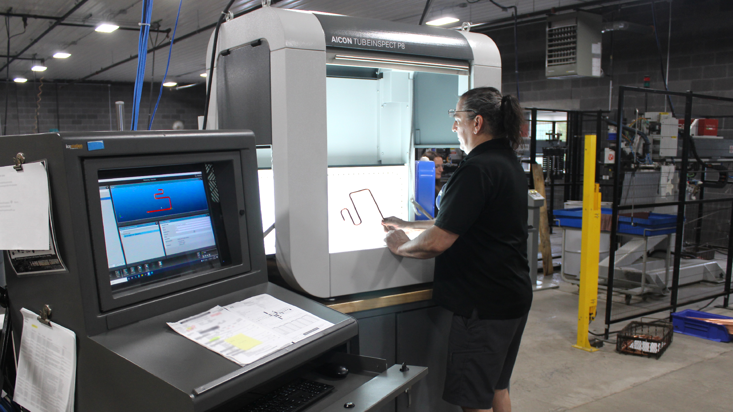

The TubeInspect is an optical tube gauge. Spinco invested in the P8 model, which has eight cameras mounted in the top of the enclosure looking down at an illuminated 40- by 22-in. measurement area. The machine uses photos from its cameras to measure the tube’s dimensions. Each photo includes a silhouette of the tube and many black dots, which are the photogrammetry targets that serve as the calibrated reference.
The BendingStudio software that runs the machine takes the photos and does the photogrammetry calculations to produce a 3D model accurate to 35 microns. Inspection is completed in about 10 seconds using the specified alignment and inspection criteria. Any deviations of the tube from nominal are calculated and translated into corrections that are fed back to the CNC benders. The process is so fast that it dramatically reduces times for bender setups, first article inspection, and periodic inspections.

Before the expansion plan, the process for setting up a new part involved setting up the machine, producing a first article, taking the first article to the inspector, and waiting for the inspector to check the part with an inspection arm. With 50 setups per day, the company’s inspection station often was a bottleneck.
Today the operators set up the machines, produce a first article, and inspect it themselves at an inspection area in the middle of the shop. If adjustments are needed, they are communicated straight back to the bender. When the part passes inspection on the optical system, the inspector simply reviews and approves the report generated by software.
