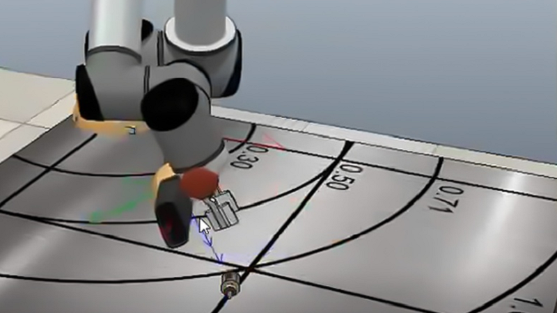

Researchers at the Institute of Industrial Information Technology (IIIT) at KIT have now developed a method that analyzes objects based on video data and machine learning. Based on previous inspections, a suitable trajectory is automatically determined for the moving camera so that the relevant object areas are clearly visible. In physics, a trajectory is the course of a space curve along which a body or point moves. The industrial 3D camera moves around the illuminated object on such a space curve and captures it as a video stream. The use of a drone is also conceivable for larger objects. A 2D representation of the surface is created from the video data. A trained neural network is familiar with different designs and states, enabling it to analyze large variances of models and states of a component in real time. The system works with two resolutions for acceleration: In the low resolution, the relevant surface areas are recognized. These are then inspected for defects using high-resolution images.
