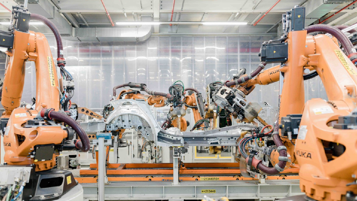

In order to address precisely these aspects when introducing AI in automobile production, Audi commissioned the Fraunhofer Institute for Industrial Engineering IAO with its research and innovation center Cognitive Service Systems KODIS and the Fraunhofer Institute for Manufacturing Engineering and Automation IPA. As part of the several-month collaboration at the Audi site in Neckarsulm, Germany there were three project stages in which possible hurdles in the introduction of AI and possible solutions for these were worked out based on the application ‘Welding of car bodies’. In essence, it was about being able to adequately secure and document future AI applications and to involve all parties involved at Audi in the development process.

In the second project step, the so-called resistance spot welding (WPS) was selected as an exemplary application and evaluated with regard to its suitability for the use of AI.ย So far, quality control has been carried out here under the guidance of a specialist.ย This means that the specialist uses ultrasound to check spot welds and classifies them as ‘okay’ or ‘conspicuous. This is a laborious process.ย In the future, this process is to be supported by AI, in which the AI โโevaluates the quality of the spot welds based on certain process parameters and thus proposes a pre-selection of conspicuous points for ultrasonic testing.
