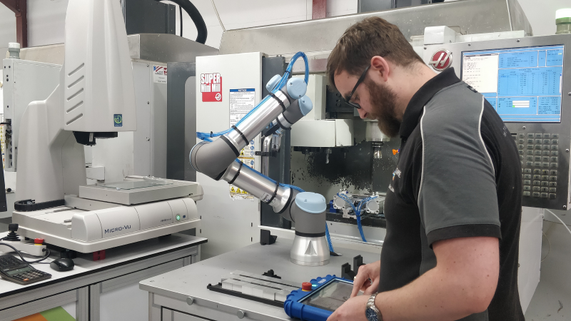

The Sempre Group designed the automated machine tending system to work alongside Hardwicke’s super mini mill CNC machine that builds the parts. The team designed gripper fingers to handle the components, modifications to the chucks and an easy-to-use pallet system. Once designed, The Sempre Group manufactured all of the parts for use as well as installing and programming a Universal UR5E collaborative robot (cobot). The system was built in one week and installed in three hours.
The cobot picks and places parts using Sempre’s own low cost pneumatic dual gripping end effector and 3D printed gripping fingers to hold the part. The team also modified Hardwicke’s existing Rohm vices for automated actuation. The robot picks the parts from a pallet, opens the door of the CNC machine, unloads complete parts from the machine, cleans the vice, loads the next part and then closes the door. Parts are then measured using an optical coordinate measuring machine (CMM).
“The system was quick to set up, flexible and viable – it went from van to operation in three hours. The Sempre Group also ensured that the system could operate safely around the team – the robot is able to detect humans in its path and execute a safe stop, removing the need to cage the system, which would take up a lot of space in the facility. The robot ran 24 hours a day, seven days a week and delivered the output we needed, meaning the team could work on our other CNC machines to produce other components.”
“We installed Sempre Connect software to the system to very easily and quickly connect and control other systems within the process,” explained Mike G John, head of engineering at The Sempre Group. “In this case we integrated a Vertex 251 Optical CMM to inspect the components and ensure compliance. Any dimensional issues could then be flagged immediately and the machine tool program assessed for changes. This instant quality feedback allows a proactive approach to superior productivity and quality control.”
Sempre Connect is a simple software that eliminates the need for programmable logic controllers (PLCs) and integrates the inspection system with the automated process. After measuring, the software verifies the part, checking that it meets specifications, and feeds this information to the automation solution to place the part in the correct place. This PC based control software is simpler, cheaper and easier to use than an industrial PLC, which is often a costly investment for SMEs because it can take months to learn how to use and program the technology effectively.
