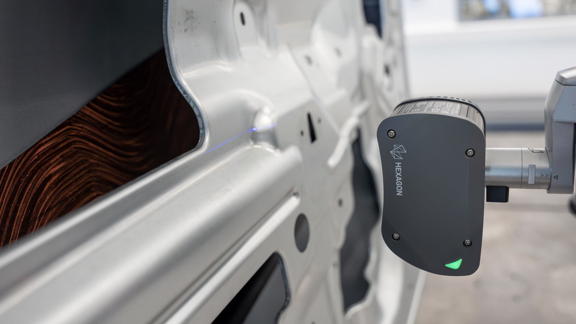

Concentrating on the core laser scanning functions, the new HP-L-10.10 LITE laser scanner makes it easy and affordable for manufacturers to benefit from the measurement speed and coverage of laser scanning. The scanner captures the complete surface data of a part in a fraction of the time compared to measuring many points or lines with tactile measurement methods.

The scanner is built upon Hexagon’s latest cross-platform laser line scanning technology. It employs the same SHINE (Systematic High-Intelligence Noise Elimination) technology as the flagship HP-L-10.10, allowing it to quickly and accurately collect clean 3D measurement data from almost any surface material and finish.
