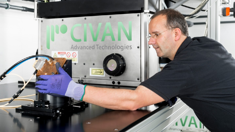

The ‘Dynamic Beam’ laser from Israel has been installed at Fraunhofer IWS.. The institute is thus the first research facility worldwide to employ such a laser solution. Together with the project partner Civan Lasers, the scientists hope that the testing will provide new application scenarios. “This laser will push the limits of materials processing, for example in medical technology and aerospace,” predicts Dr. Andreas Wetzig, who heads the Cutting and Joining technology field at Fraunhofer IWS. He refers to the research project ‘ShapeAM’ within the European network program ‘M-era.Net’, in which this new laser will play a central role and which started in July 2021.
