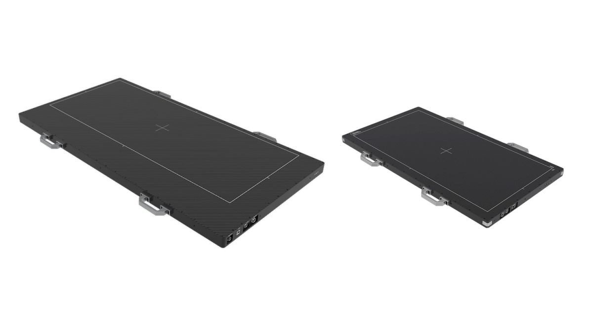

Detection Technology, a leader in X-ray detector solutions, has announced the launch of the X-Panel 4386a FPI, the latest addition to its X-Panel XL series of large-area thin-film transistor (TFT) flat panel detectors. Building on the strong market response to the single-glass X-Panel XL platform, the new detector extends the product family with industry-leading speed and an optimized large-area form factor featuring a 430 × 860 mm active area for high-speed industrial computed tomography (CT) imaging applications.
The X-Panel XL series, originally launched with X-Panel 43108 variants, addresses the growing demand for high-throughput inspection of large objects in industrial imaging. Developed in close collaboration with customers, the X-Panel 4386a FPI expands the product family with a 430 x 860 mm active area detector for demanding dynamic imaging applications.
“The launch of the X-Panel 4386 as a successor to the X-Panel 43108 demonstrates our commitment to continuously expanding the capabilities of the X-Panel XL series,” said Tuomas Holma, Product Director at Detection Technology. “Customers have shown tremendous interest in large-area dynamic detectors that improve throughput and imaging quality while enabling entirely new system concepts. The X-Panel 4386 enables faster and more flexible industrial imaging system designs.”
The X-Panel 4386a FPI features dual-side readout architecture that enables frame rates of up to 15 fps in full-resolution mode, 45 fps in 3×3 binning mode, and 90 fps in 6×6 binning mode. This makes the detector more than five times faster than many competing large-area detector solutions currently available on the market.
The detector is based on a-Si TFT technology with a 140 µm pixel size and a pixel matrix of 3072 x 6144. It provides an active imaging area of 430 x 860 mm and supports 10G BASE-T connectivity for high-speed data transfer. The detector is optimized for high-energy X-ray tube imaging applications, with scintillator options including DRZ-Plus and Cesium Iodide (CsI).
