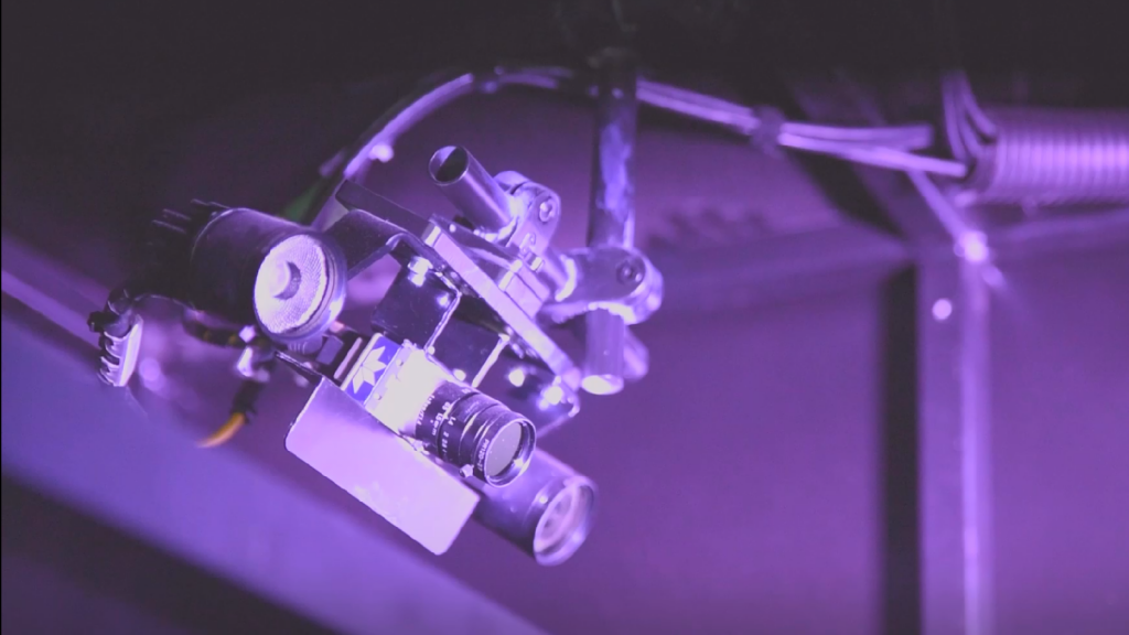

To ensure the highest quality standards, the custom vision system was developed and tuned to highlight subtle defects that only experienced quality inspection workers would notice, defects that would be invisible to the naked eye. “Challenges are our strength,” smiles Pistilli. “We do what other companies do not want to do because of risks and uncertainty of results. We like challenges.” MOSAIC selected flowchart-based Matrox Design Assistant® X vision software because of its effectiveness, precision, and rapid response.”
Matrox Design Assistant X software runs on an HP workstation equipped with an Intel Core™ i9 processor and three Matrox Concord PoE frame grabbers, which acquire and process the images coming from nine Teledyne DALSA cameras—seven Genie Nanos and two line scan models. A custom-built lighting system uses MidOpt filters on camera lenses and spotlights. The vision system interacts with a PLC via fast-scan modules and an encoder; hardware triggers come directly from the PLC.
Every camera has a different shooting position; images are captured while the disks pass through the inspection tunnel on the moving production line. As the system comprises multiple cameras, Pistilli notes, “Matrox Design Assistant X is the right tool because of its ability to spread the load over the available CPU cores, and the possibility to synchronize all elements of the systems with ease. Moreover, this flowchart-based software allowed our developers to focus more on achieving our desired accuracy and performance, and the algorithm logic, instead of worrying about coding.”
