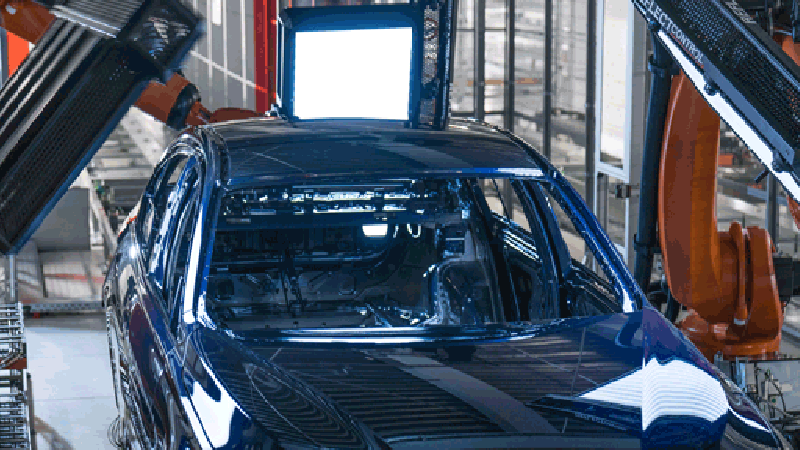

The sensor capture directly reflective surfaces with exceptional clarity. These sensors generate detailed 2D images, forming the basis for creating 3D point clouds. Multiple layers of 2D images from two perspectives are generated: The base intensity picture to identify the brightness, the amplitude picture to detect differences in reflectivity, and a curvature picture for recognizing deviations in the surface structure.
The reflectCONTROL sensor is a compact, 3D noncontact surface inspection system that enables fast, reliable defect detection on shiny and reflecting surfaces such as polished or painted metals, glass, mirrors, painted plastics, and galvanized surfaces. Based on the deflectometry principle, the reflectCONTROL sensor can be used in a stationary mode for assembly lines or mounted on a robot to perform inline inspection. Inspection cycles are <2 s/measuring position and the sensor provides a large measuring field.
