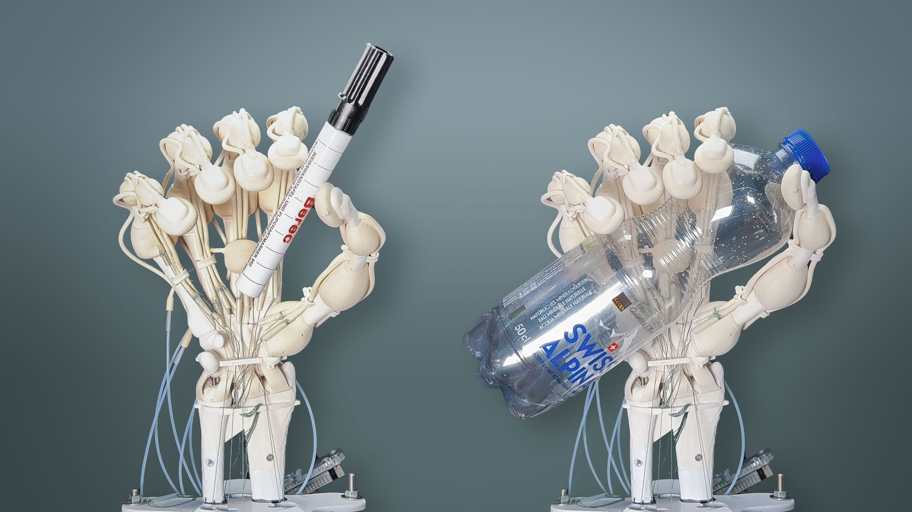

“With Inkbit’s VJC technology and materials, for the first time, we were able to print something as complex as a robotic hand with bones, ligaments and tendons, mirroring a fully functioning human hand, and do so in one go,” said Thomas Buchner, doctoral student at ETH Zurich. “Inkbit’s TEPU material has very good elastic properties and bounce back to their original state much faster after bending than polyacrylates, making it ideal for producing the robotic hand’s elastic ligaments.”
