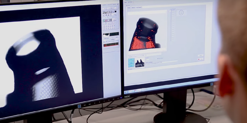

PFW Aerospace was selected as a pilot customer and will receive an AI prototype including test operation and a statistical qualification report.
The application is for X-rays of longitudinally welded seams on titanium tubes. The test parts are subject to very high-quality standards because they are installed in aircrafts around the world. PFW will collect X-ray images over a defined period of time, which VisiConsult will then use as a basis to train AI networks. The Ai itself is operating on secure industrial platform developed in collaboration with the AI ​​pioneer FUJITSU.
Qualification By Testing
In order to qualify this new technology according to the demanding inspection standards, sufficient statistical data about the accuracy of the algorithms must be available. Therefore, there is a permanent comparison of the AI ​​results with the decisions of experienced NDT inspectors. With the help of this input, the neuronal networks are also regularly re-trained. Only when a sufficiently good detection probability (POD) has been proven the system can be qualified and used in production.
More Quality Through More Intelligence
PFW Aerospace sees artificial intelligence for defect interpretation as a future-oriented tool for its quality department: “This will save our employees a lot of time interpreting X-ray images, and this time is ultimately available for other important tasks.” The use of AI is expected to significantly increase the efficiency of non-destructive testing. It sorts out components with detected deviations and only forwards the necessary X-ray scans to the inspectors for final approval by humans. The information about defect locations and trends can also be sent to the development team in order to optimize design data. Gutensohn assures: “The final quality approval will continue to be done by our highly qualified NDT colleagues.” The motto here is: Safety First!
