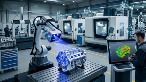

Saccade Vision’s system, which can check all machined parts after processing, features a microelectromechanical system (MEMS) laser illumination module as a light source. It scans the metal in all directions, but people can optimize the scan direction to avoid turning the part during quality control checks.
Saccade Vision’s approach also uses 100 million three-dimensional points when gathering data about a component. However, it works without needing a large data set by continually focusing on the most meaningful aspects of the part being inspected.
Moreover, the technology can change its resolution by scanning some sections of a component at low resolution but switching to a high-resolution scan across specific areas. That could be useful if companies have had particular quality issues and must reduce them. This system also uses a single robot for loading, unloading and inspecting the parts, allowing manufacturing leaders to minimize their overall robotics investment without compromising results.

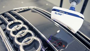

General Motors uses a 3D robotic scanning system at one of its electric vehicle factories, which is a significant part of quality control. It measures the car’s body and all frame dimensions to verify they meet specifications. Workers then receive a color-coded map showing which components fall outside those parameters. This part of the process took six hours before the company started using robotics to complete it. It now gets done in two.
