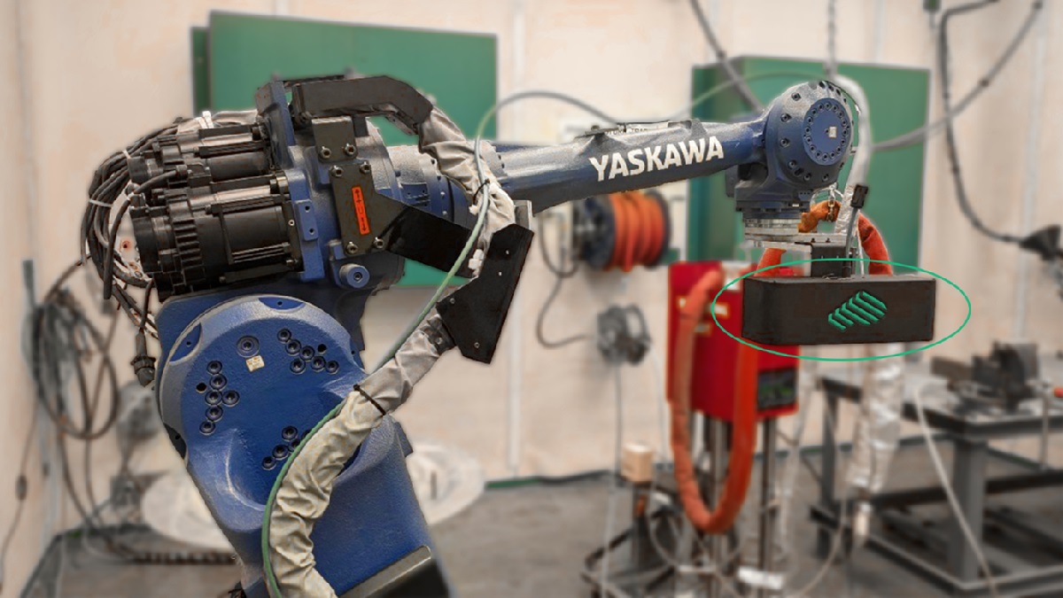

Phase3D designed, prototyped, programmed, tested, and deployed the Fringe Inspection: Cold Spray product at UDRI and Ellsworth Air Force Base. The hardware, attached to a robotic arm, capturing millions of measurement points related to layer thickness, roughness, and shape in real-time. The Fringe Operator software inspection suite was used to identify spray defects and records part-centric quality data.
