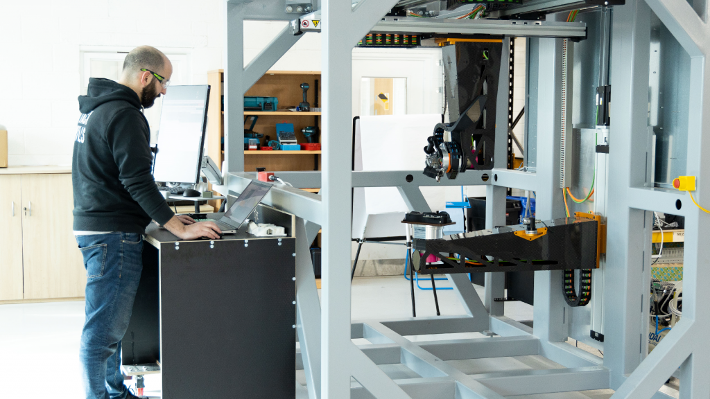

The AMRC, part of the High Value Manufacturing (HVM) Catapult, was tasked with devising a proof-of-concept solution to calculate the position and rotation of a workpiece to enable the robot to fully automate the process of embedding wiring into them for use in the aerospace sector, as well as creating integrated validation processes for quality inspection.
Edwin Anarcaya Roca, research engineer at the AMRC, said: “Q5D tasked the AMRC with making sure the position and rotation angle of the workpiece produced the best possible accuracy, while maintaining high repeatability and a fast computational process. To obtain this, AMRC engineers performed a number of trials to identify the right hardware and software that would be best suited and supported the company in implementing a proof-of-concept solution using a stereo vision camera.”
The benefits of automating the robot path using a vision system will provide Q5D’s robotic technology with greater flexibility to adapt to dynamic environments. Making automatic adjustments to the robotic path on the fly will increase productivity as it will decrease the manual programming needed to re-adjust the robot tool path.
Roca added: “The AMRC also implemented proof-of-concept computer vision solutions to automate the wiring inspection. These solutions include algorithms that detect defects such as wire breakages, crushed wires, stripped wire insulation, wires escaping from the track and incomplete track walls.”
“The techniques used in these defect detection algorithms could lead to the development of a real-time, embedded wiring defect detection system integrated with the machine itself. Even though this project was looking at a pathway for use in the aerospace sector, this concept can be transferable to any robotics automation system.”
