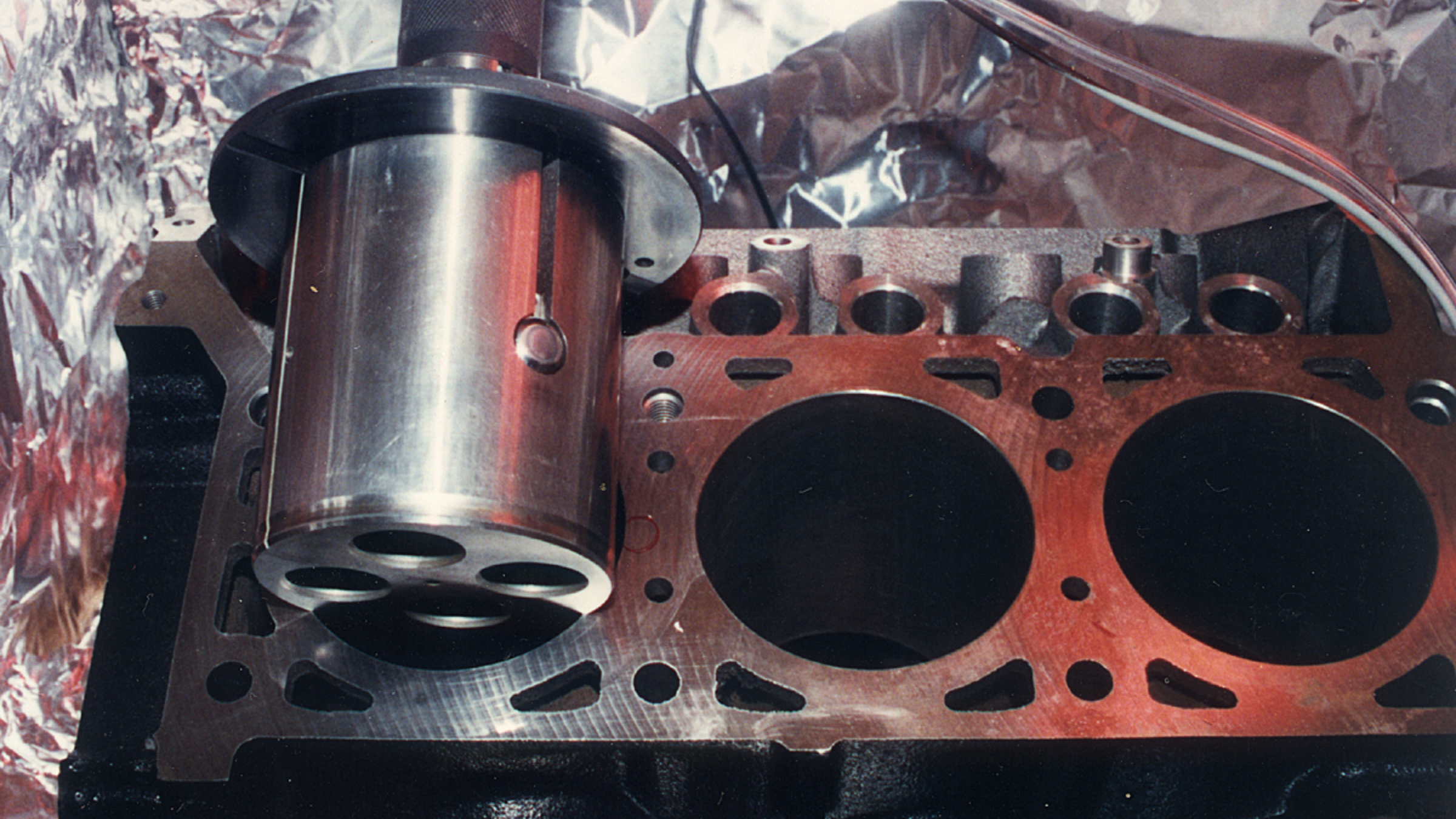

When certain parts are measured after precision machining or cleaning operations, or after otherwise being exposed to temperatures other than the reference temperature, 20°C/68°F, their dimensions can be significantly altered by thermal expansion or contraction. Gage fixtures and masters may also not be at reference temperature. The result will be that erroneous measurements will be taken unless this is taken into consideration. Normalization to 20°C/68°F before measurement can take precious time. The quickest and most economic option is to compensate for those errors in real time while taking measurements.
Albion Devices, Inc., has successfully delivered and maintained literally thousands of so-called ‘3 element’ temperature compensation systems. They are used in gages to determine true size at reference temperature of machined components such as automotive pistons and pins, crank shaft journals, engine and transmission bores, railroad axle journals, bearing rings, differential carrier parts, large forged parts such as marine gears and shafts, turbine journals, etc.
Obtaining the best results from an electronic temperature compensation system requires several inputs. Coefficients of Expansion (COE) of workpiece, master and gage fixture or frame (elements) are user-programmed into the controller, along with relevant dimensional data relating to the workpiece. Live temperatures of each of the elements are collected from purpose-designed industrial sensors and transmitted to a micro-controller during operation. The controller computes a net correction for thermal errors in real time and this solution is then added to or subtracted from the gaged dimension so as to arrive at the temperature corrected size of the workpiece.
