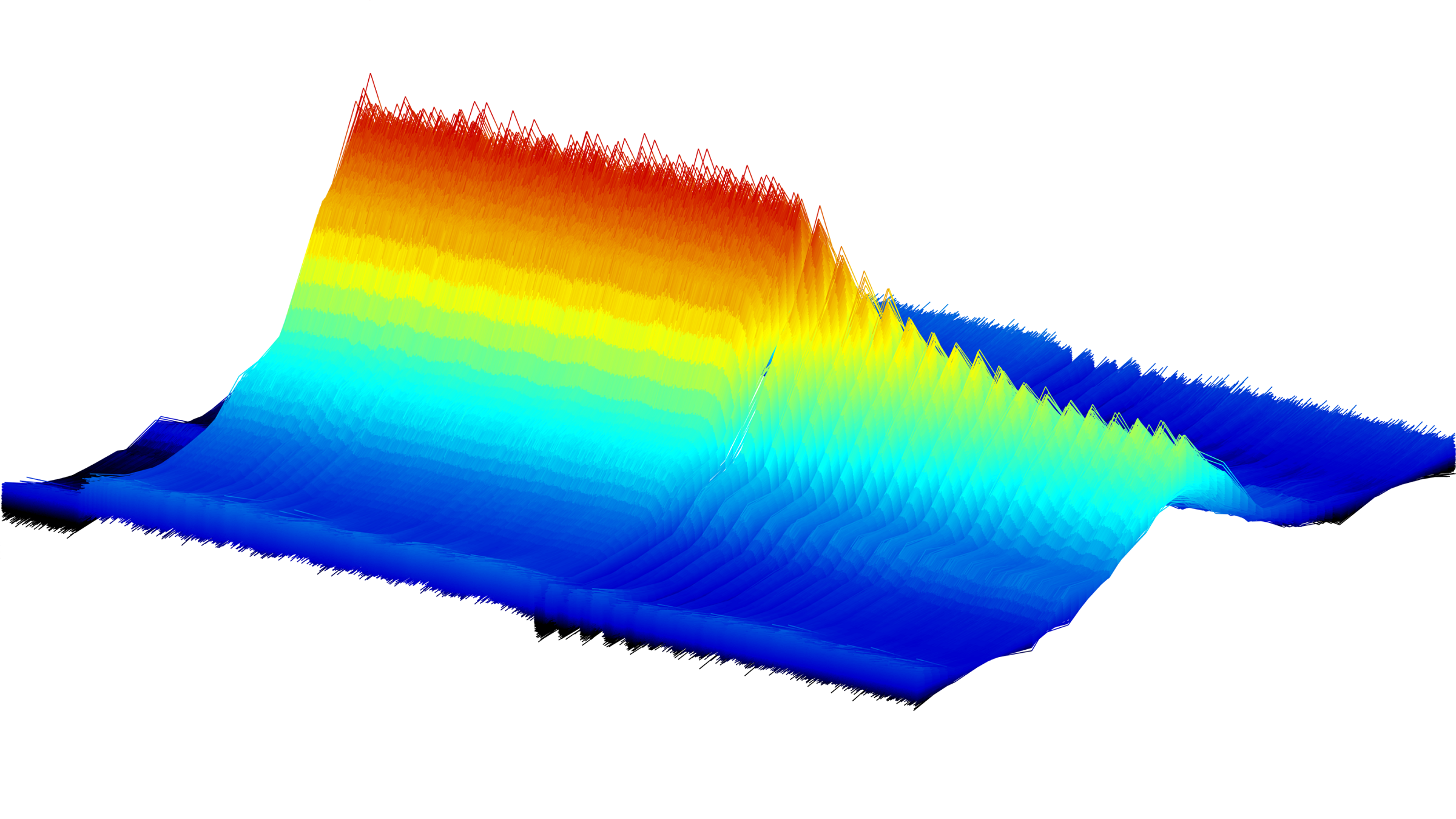

In their demonstration, the researchers used the instrument to measure supersonic pulses of CO2 emerging from a small nozzle in an air-filled chamber. They measured the CO2 mixing ratio, the proportion of carbon dioxide in the air. The changing concentration of CO2 told researchers about the motion of the pulse. The researchers saw how the CO2 interacted with the air and created oscillations of air pressure in its wake. Such details are often hard to accurately obtain even with the most sophisticated computer simulations.
