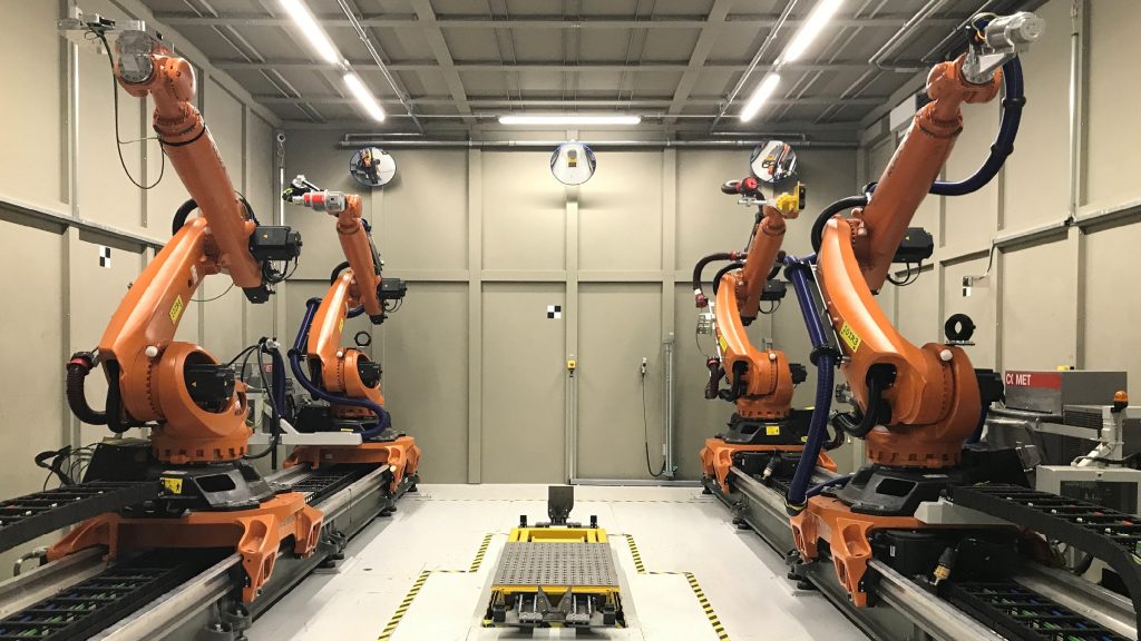

3D Computer Tomography Scanning of Automobiles
Realtime Robotics RapidPlan helped to improve the process around the 3D computer tomography scanning of automobiles, which is done to assure the quality of assorted joinings. The cell was designed to use robots to x-ray vehicles and identify any issues, but it was a time-consuming process to complete for even a single automobile. The robots used needed to be programmed with the exact geographies of the vehicles they’d be working around and scanning. Making it even more difficult, each vehicle model was different, meaning robot programming reuse was limited.
Realtime Robotics’ technology improved how the robots in this operation are programmed. By autonomously generating and choreographing all robot movements and making them collision-free, the team could immediately understand which scan points were easily reachable and which ones needed direct attention.
With RapidPlan in place, customers are able to improve the efficiency of their scanning operation, automating the robot movements and optimizing the scan points, which enables technicians to concentrate their efforts on setting up and validating the remaining tough-to-reach areas, instead of wasting time reviewing and validating them all.
