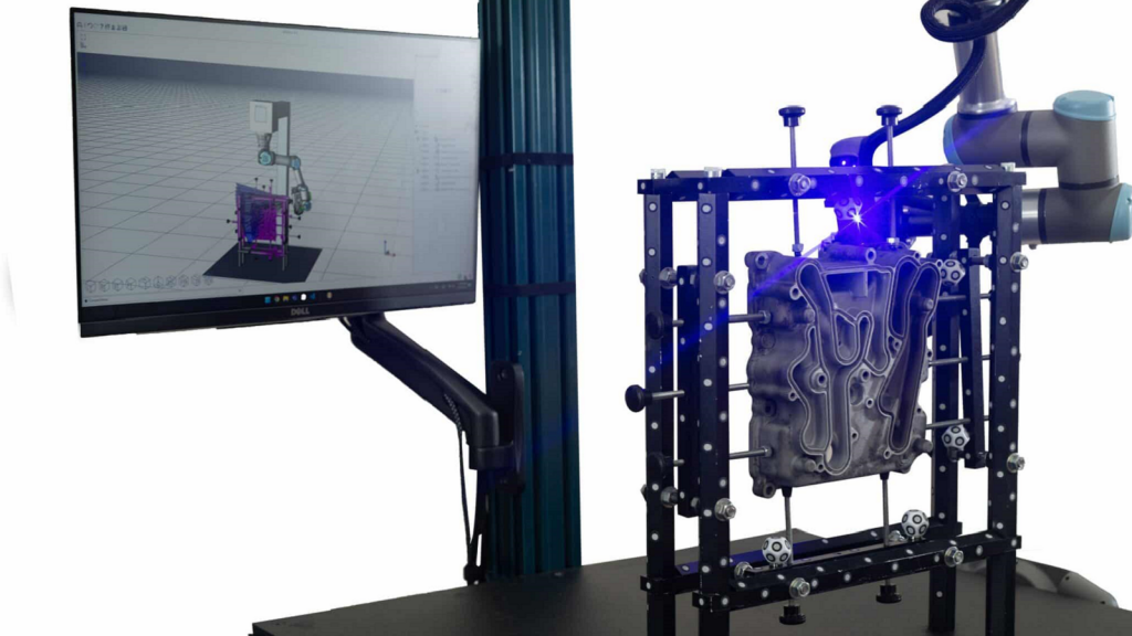

The RM-300 is built on a rolling cart platform with a compact, space-saving design, bringing practically plug-and-play automation to part inspection and quality control. With technical specifications including 20-micron accuracy, no need for powder on dark or shiny surfaces, 2 million points/second, automatic inspections, and customizable scan paths.
Digitize Designs designed and exclusively offers the RM-300, built on the Vention platform, using Scantech Simscan for 3D scanning sensor, Universal Robot’s URE3 for robotics, a custom-built PC, Touchscreen Monitor, Nexos’ software for robotics and 3D scanning, and Polyworks Inspector software for automated inspections.
