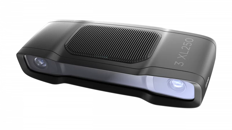

Zivid has announced the release of its latest industrial 3D camera, the Zivid 3 XL250, engineered to deliver fast, accurate, and reliable 3D vision for large-scale automation applications such as depalletizing in logistics and bin-picking in manufacturing.
Building on the proven Zivid 2+ R Series, the new Zivid 3 platform brings enhanced point cloud fidelity, faster capture times, and superior environmental robustness. Capable of capturing full pallets or large bins in under 500 milliseconds, the XL250 enables robots to handle mixed-SKU pallets up to 2.5 meters high and workspaces up to 4.5 meters away – with consistent millimeter-level accuracy.

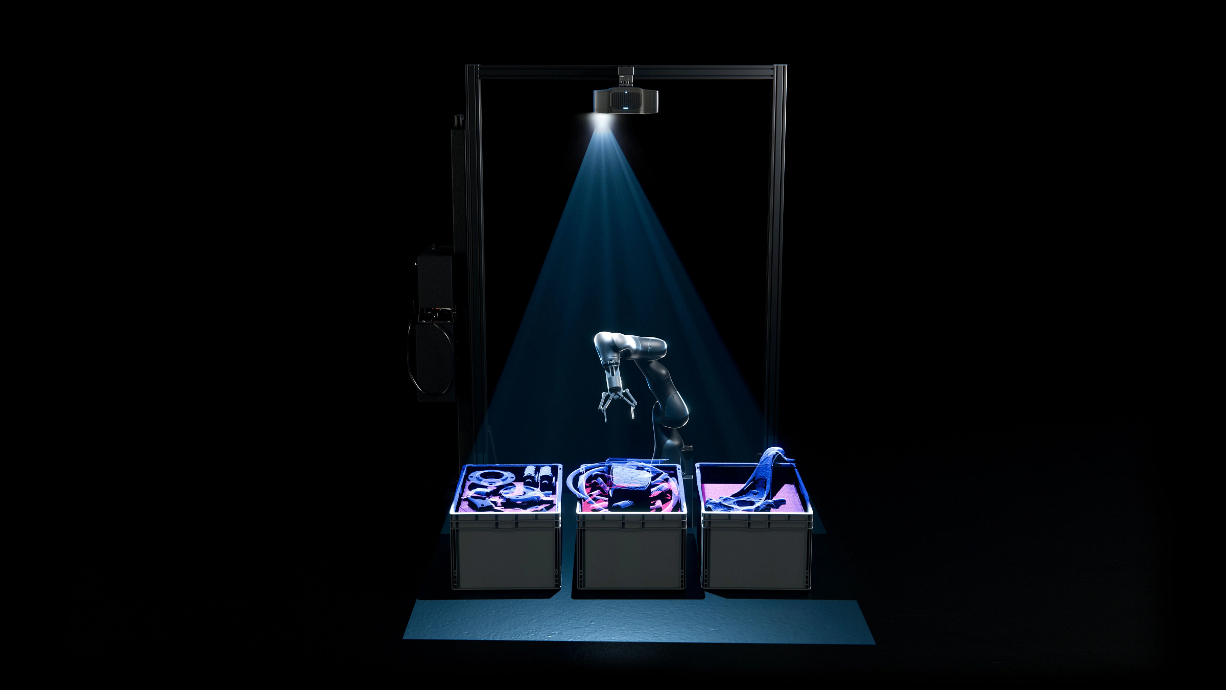

Designed for stationary mounting and large working volumes, the Zivid 3 XL250 offers a 2.5 m² field of view, giving robots the visual coverage needed to manipulate full pallets, large boxes, and deep bins in a single shot.
The camera combines 8-megapixel RGB and 3D sensing, producing synchronized 2D images, depth maps, and point clouds for every capture. With less than 0.2% trueness error, it provides the precision required for robots to pick the right item the first time – every time.
“This 3D camera allows us to detect items within a few millimeters.We can handle items successfully without fail, pushing the boundary beyond 99.9% performance,” said Floris Gaisser, Computer Vision Team Lead at Mujin, a leader in robotics automation.
The Zivid 3 XL250 allows robots to “see everything and do anything – from anywhere,” making it ideal for high-speed depalletizing, truck unloading, and large-bin picking tasks that demand accuracy, speed, and reliability.

A standout innovation in the Zivid 3 XL250 is its eye-safe blue laser light source, which offers exceptional ambient light suppression and imaging consistency in environments exposed to daylight or strong artificial lighting.

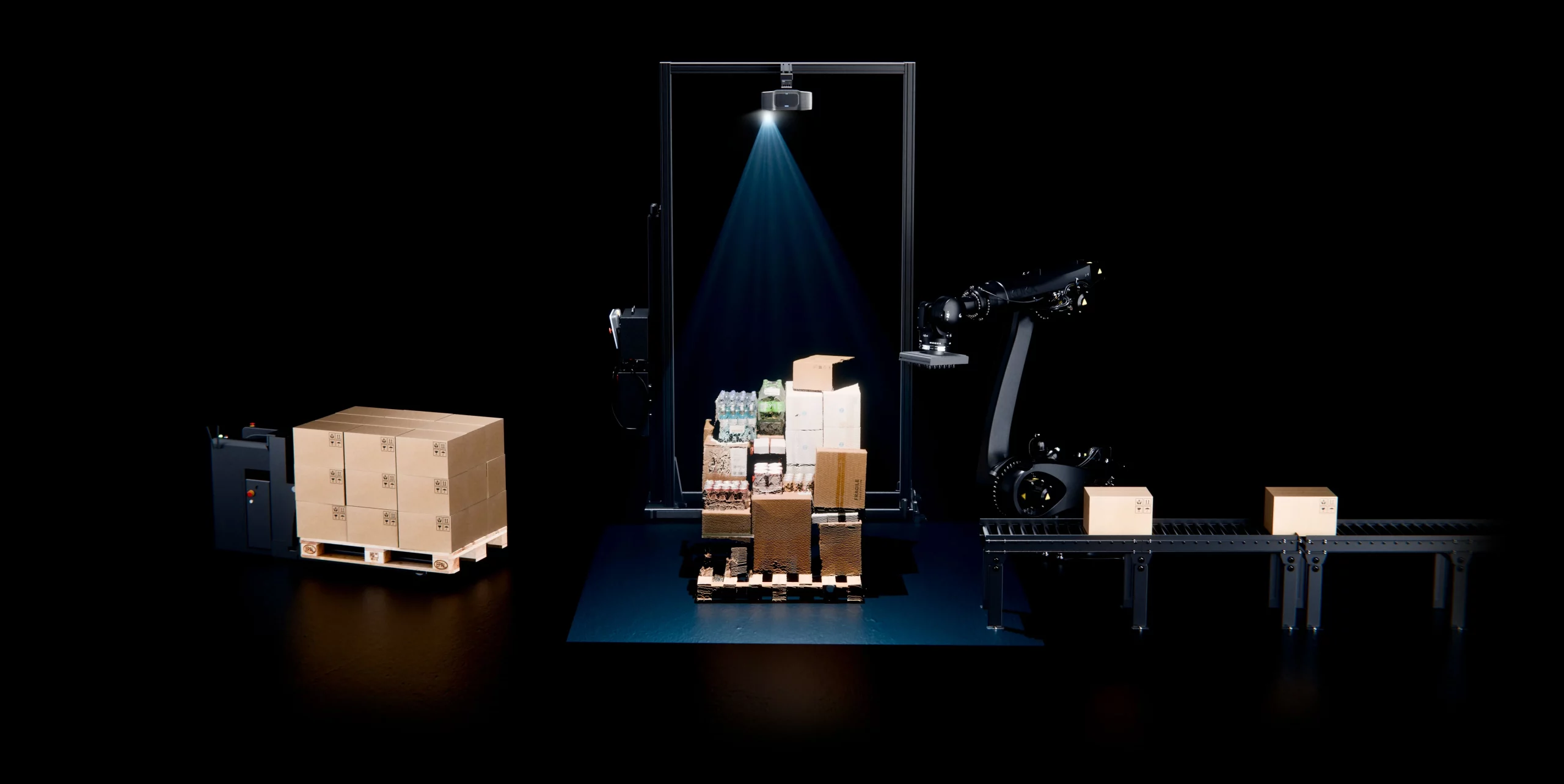

Warehousing and logistics operations often place depalletizing cells close to loading bay doors, where lighting and temperature can change dramatically throughout the day. The XL250’s blue laser maintains image quality and point cloud completeness even under direct sunlight, ensuring reliable detection and picking performance regardless of ambient conditions.

Whether tackling mixed-SKU depalletizing, unloading trucks, or automating large-bin picking in manufacturing plants, the XL250 provides the speed, precision, and resilience needed to enable the next generation of intelligent, vision-guided robots.
