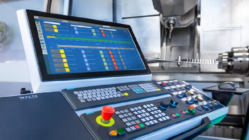

The WFL Health check ensures optimal performance through checking the machine geometry. With semi-automatic measurement and measurement data logging, the system offers an efficient solution that can be used on all MILLTURNs achieving maximum precision and productivity for the manufacturing processes.
With the latest tool called myWFL Health Check, the machine geometry is checked by semi-automatic measurement of the milling spindle and tailstock as well as the main and counter spindle. The software also includes cycles and test equipment for measuring and logging the geometry. The myWFL Health Check can be used and retrofitted on all machine types and controls, regardless of whether the machine is equipped with different special options. The entire programme takes about 25 minutes. Long-term trends can be identified due to the integrated measurement data logging.
myWFL Health Check Steps
First, the roundness and alignment of the milling spindle is measured with a test mandrel in the milling spindle. This is done with different B-axis angles and different clamping states (milling spindle clamped / unclamped, B-axis clamped / unclamped, …) The repeat accuracy of the measuring probe is then checked using the calibration ring. Next, the machine zero point is checked in the X and Y directions. The machine operator must then clamp a short shaft in the chuck to check the alignment of the headstock. In the last step, the operator clamps a long workpiece between the chuck and tailstock / counter spindle, after which the position of the tailstock / counter spindle is automatically measured in relation to the main spindle. All measurement results are stored in a measurement database and can be compared with previous measurement results.
Depending on the machine version, the Health Check program saves up to 57 measuring points in the measurement data log.

The machine geometry is checked by semi-automatically measuring the milling spindle and tailstock as well as the main and counter spindles.
To summarize, the myWFL Health Check is a quick check of the machine geometry in just a few minutes. It is a simple method to avoid scrap parts, it includes both the necessary hardware and software and thanks to the integrated measurement data logging, long-term trends can be identified. The complete health check cycle is a quick but very efficient affair and takes about 25 minutes.
The myWFL Health Check can be used and retrofitted on all machine types and control systems.
