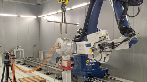

The IONA system was set up in Loop’s Advanced Automated Preforming Technology (ADAPT) cell. The cell comprises of a pair of large industrial robots on a linear rail, to create a large and highly flexible working area. Two robot programs were tracked by IONA, one consisted of the robot moving to multiple fixed points, and the other was a continuous dynamic path. For each program, multiple repeats were performed and datasets were collected from IONA.
IONA was able to track the FibreFORMÂ end-effector accurately relative to a tool, in all positions and orientations used in the robot programs with no line-of-sight limitations. IONA delivered a 20X faster alignment process, 10X increase in process accuracy and 100% process confidence through 24/7 monitoring.
