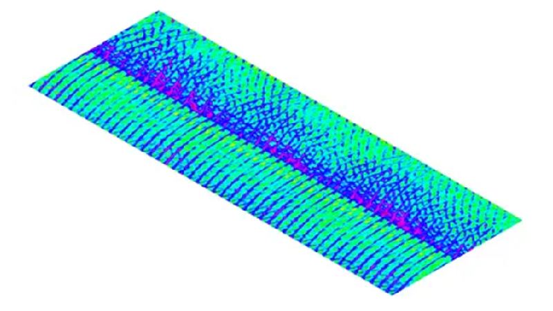

Elevations, Plateaus and Valleys
Not only are bumps displayed, but their statistical distribution on the surface can be evaluated with the area measurement. The profile measurement along a line can show how high or deep peaks and valleys are, but not the entire extent of the unevenness, because the distances on the y-axis are not recorded.
Isotropic or Anisotropic
Isotropy is a preferred direction. This means that the structures on a surface repeat in one direction. This may or may not be intentional. Most surfaces have such an orientation. And it is those structures that are not known in advance that can be lost in the profiled measurement. Besides, you need to draw the profile normal to the structure to capture the isotropy, and that is rather unlikely if you don’t know the preferred direction. In the areal roughness measurement, the structure shows up in any case – whether you were aware of it in advance or not.

Structured Surfaces: Here, the situation is somewhat different. The structure makes it necessary to take at least several or a large number of profiles in order to be able to make a statement about the condition. This is of course possible – even with tactile systems, but it takes a lot of time and will never be one hundred percent accurate because it is always only partial samples. Therefore, for structured surfaces (e.g. lasered), the area-based measurement should be used immediately!
