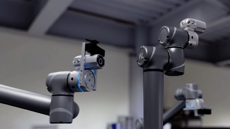

Techman developed AOI with its factory-floor robots by using Isaac Sim to simulate, test and optimize its state-of-the-art collaborative robots, or cobots, while using NVIDIA AI and GPUs for training in the cloud and inference on the robots themselves.
Unique features of Techman’s robotic AOI solutions include their placement of the inspection camera directly on articulated robotic arms and GPUs integrated in the robot controller. This allows the bots to inspect areas of products that fixed cameras simply can’t access, as well as use AI at the edge to instantly detect defects.
