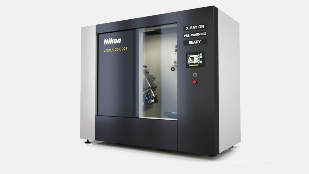

Nikon Corporation has launched the VOXLS 20 C 225, the latest addition to its VOXLS X-ray CT product lineup. This system is based on the proven principles of the company’s VOXLS 30 and 40 Series systems while offering maximum capability in a space-efficient footprint, providing unparalleled value per voxel in the market.
The VOXLS 20 C 225 offers the largest CT scanning envelope in a system that fits through a standard double door, allowing for flexible integration to almost any quality control laboratories and production environments.
The new system features Nikon’s metrology-grade platform with a granite base, rigid steel manipulator towers, and high-accuracy encoders and motors. These engineering choices ensure the precision, repeatability, and reliability that the Nikon brand is known for while delivering exceptional X-ray and CT data quality.
Key features include:
Superior CT Inspection Envelope: Offers an industry-leading inspection volume of 555Â mm (Dia) x 759Â mm (H) in a compact footprint of just 2,451Â mm (L) x 1,173Â mm (D).
Dual-Source Configuration: Features a motorized dual-source setup with a 225Â kV reflection target and 160Â kV transmission target, allowing users to choose the optimal source for their application at the push of a button. This enables automated and fast switchover between the reflection target (for higher productivity due to increased X-ray flux) and transmission target (for achieving the best possible resolution).
Source Optimization:Â De-skills the process of setting up the filament for optimal performance, simplifies the filament change process, and provides longer filament lifetime.
Enhanced Usability: Incorporates features like Filter Changer, motorized door that opens in under 4Â seconds, and large viewing window for excellent interior visibility.
Versatile Scan Capabilities: Supports Motorized FID and advanced scan modes including Panel Shift CT, Tilted CT, and Pixel Split CT, enabling a wide range of inspection techniques for diverse applications.
