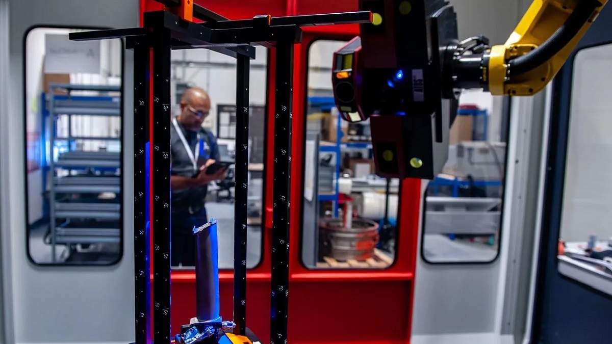

Developing and Integrating Dimensional Metrology Systems
One of AddQual’s key offerings is component qualification services, including capturing and reporting metrology data for parts ranging from 2mmÂł to 2mÂł across a variety of materials. Anderson explains the necessity for this: “OEMs and MROs in safety-critical industries often grapple with unclear or incomplete inspection requirements. This can lead to significant delays and costly rework. AddQual steps in to partner closely with customers, helping them clarify and refine their metrology requirements, ensuring precise alignment with stringent safety and quality standards.” By developing and integrating dimensional metrology systems, AddQual provides an autonomous approach to inspection and improvement.
Production inspection is another critical area where AddQual provides solutions. The sheer volume of metrology and quality control data being collected can overwhelm manufacturers, leading to a ‘doom loop’ of information overload without actionable insights. Anderson elaborates: “Companies are drowning in data, yet struggling to extract meaningful insights. Our production inspection services leverage metrology and fixturing expertise, automation, and data management software to optimise process outputs. This moves manufacturers away from relying on engineers’ subjective interpretation and towards a structured, automated approach.”
