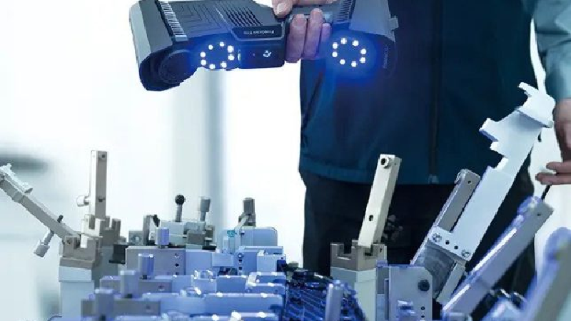

SHINING 3D has announced updates to its FreeScan Trio, the marker-free laser scanner designed for accuracy and efficiency. After first unveiled at Formnext 2023, the FreeScan Trio now features enhanced hardware and software capabilities, providing users with more versatile and streamlined scanning solutions.
At the heart of the FreeScan Trio is its advanced intelligent self-positioning technology, drastically reducing preparation time and streamlining workflows for large-scale projects by eliminating the need for markers. The system incorporates three industrial-grade 5MP cameras, it excels at capturing fine details, offering unparalleled high-detail acquisition with or without markers.
In response to user feedback and industry needs, SHINING 3D has continued the ease of use of the previous software and introduced more powerful features that elevate the FreeScan Trio’s capabilities:
Deep Hole Mode: With the addition of the new Deep Hole Mode, the FreeScan Trio redefines its capabilities. Both the 26-laser line and single-laser line configurations now enable holes, deep pockets, and narrow fin walls scanning, facilitated by optimized camera angles and advanced algorithms.
Real-Time Display of Mesh Data: Users can now opt for direct mesh scanning, bypassing the need for point cloud conversion, to save valuable time.
Data Quality Visualization: Intuitive, color-coded feedback ensures every scan is flawless, guiding users in real-time.
Unprecedented Resolution: Achieve stunning detail at a resolution of 0.05 mm in the 98-line mode, perfect for capturing fine textures.
Customized scanning template: Streamline batch inspections and repetitive workflows by saving and reusing parameter settings and global markers.
Button-Controlled Scanning: Adjust settings directly on the device for a more intuitive, seamless scanning experience.
By combining powerful hardware and smarter software, FreeScan Trio offers a reliable, efficient, and versatile tool for tackling a wide range of scanning tasks for quick inspection.
