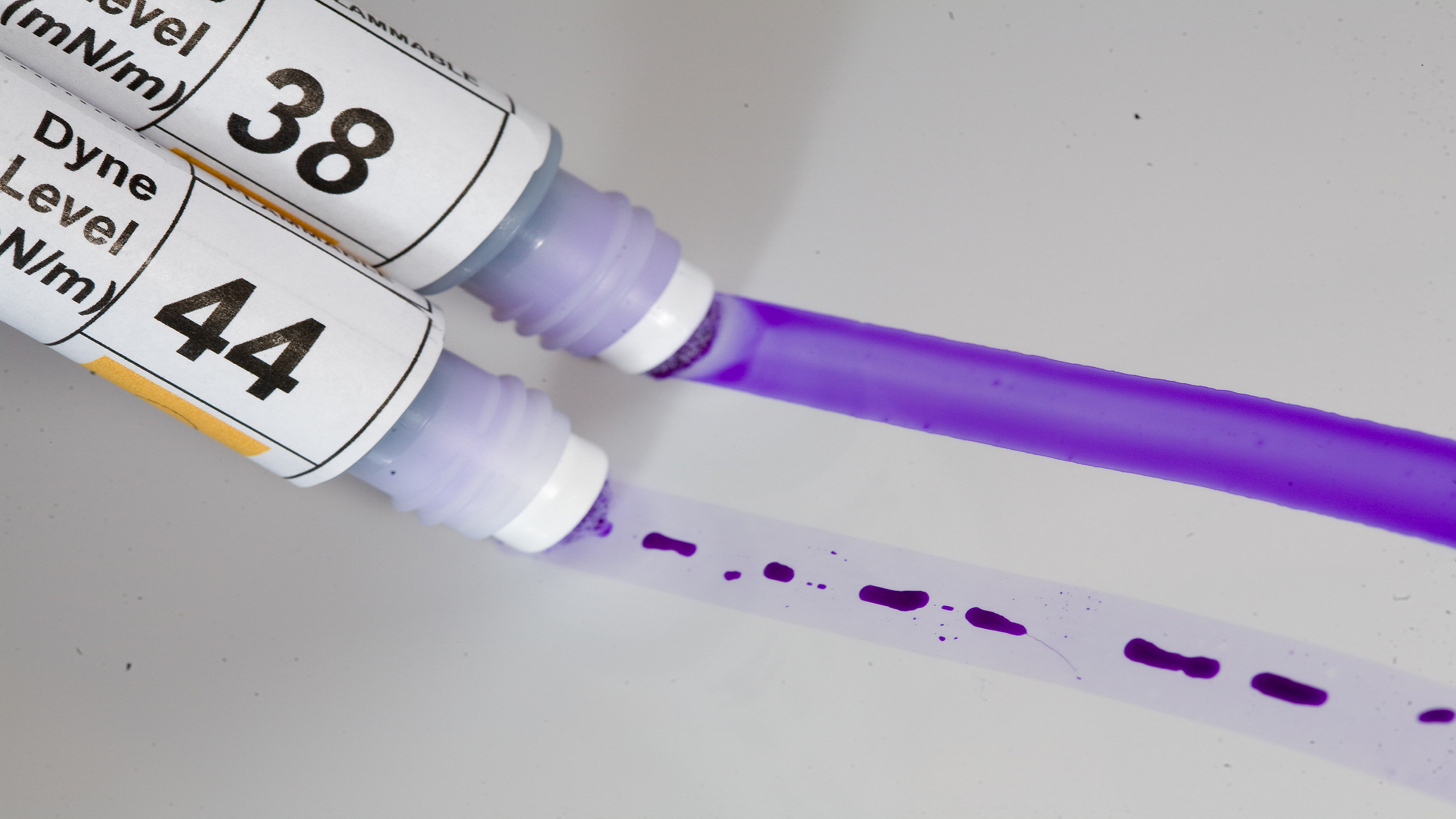

The Dyne Pen test is a simple method of determining the surface energy of most polymer-based materials in line with ISO 8296 and ASTM D2578-84. It is used to help understand the surface energy and wetting characteristics of polymers, and their suitability for bonding, coating, painting, or printing. Test results will inform the need for surface preparation, such as cleaning, or plasma, corona, or flame surface treatment.
Dyne Pens are available in a range of values from 30 to 72 “Dynes”. To perform the test, the user selects a pen, and draws a line on their substrate. The test ink will either form a continuous film on the surface or draw back into droplets. If the test ink stays as a film for 3 seconds or more, then the substrate’s minimum surface energy (measured in mJ/m², mN/m, or dyne/cm) is lower than the test ink. The surface energy of the substrate can be determined within a tight tolerance by applying a range of increasing or decreasing values of test inks and observing the wetting. Users can also purchase inks in bottles, which can be spread using a brush, spreader or drawdown bar to perform the test.
There are two types of Dyne Pen, the ISO Type, which is based on ISO 8296:2003 ink specifications, and a Non-Toxic range, an ethanol-based alternative. The ISO Type is available both in pen format and as bottles of ink, which are purple in colour. The non-toxic range is available as ink only and is yellow in colour. Test inks also have application in assessing contamination on metal surfaces.
