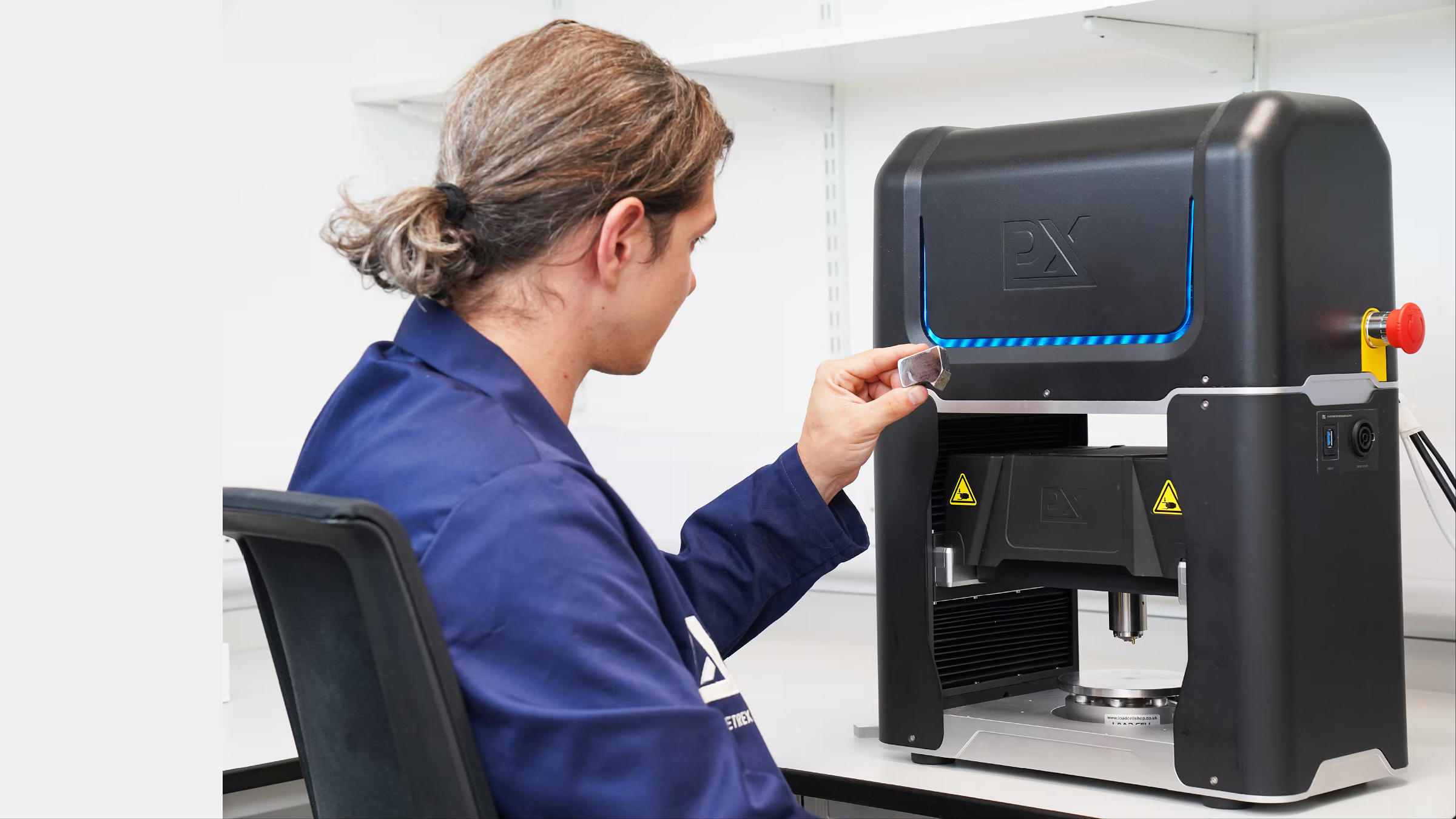

Developed in response to a common gap in mechanical testing, the new MultiScale capability for Plastometrex’s PLX-Benchtop testing system enables engineers and materials scientists to:
• Test directly on components and specimens as thin as 0.75 mm, extracting accurate mechanical data without destructive sectioning.
• Map mechanical properties across welds and complex geometries with 1.5 mm indent spacing, providing high-resolution insight into local variations and process performance.
This innovation is powered by Plastometrex’s ASTM standardised PIP Testing (Profilometry-based Indentation Plastometry), a physics-based approach that extracts stress-strain curves from indentation test data using accelerated inverse finite element analysis. It’s this testing methodology that underpins the PLX-Benchtop: a fast and compact system that non-destructively gathers yield and ultimate tensile strength (UTS) data from an automated five-minute test. The standard indenter size in every PLX-Benchtop device is 1000 µm; however, with the addition of the MultiScale capability, users now have access to 250 µm and 500 µm indenters, allowing mechanical behaviour to be captured at a variety of scales.
