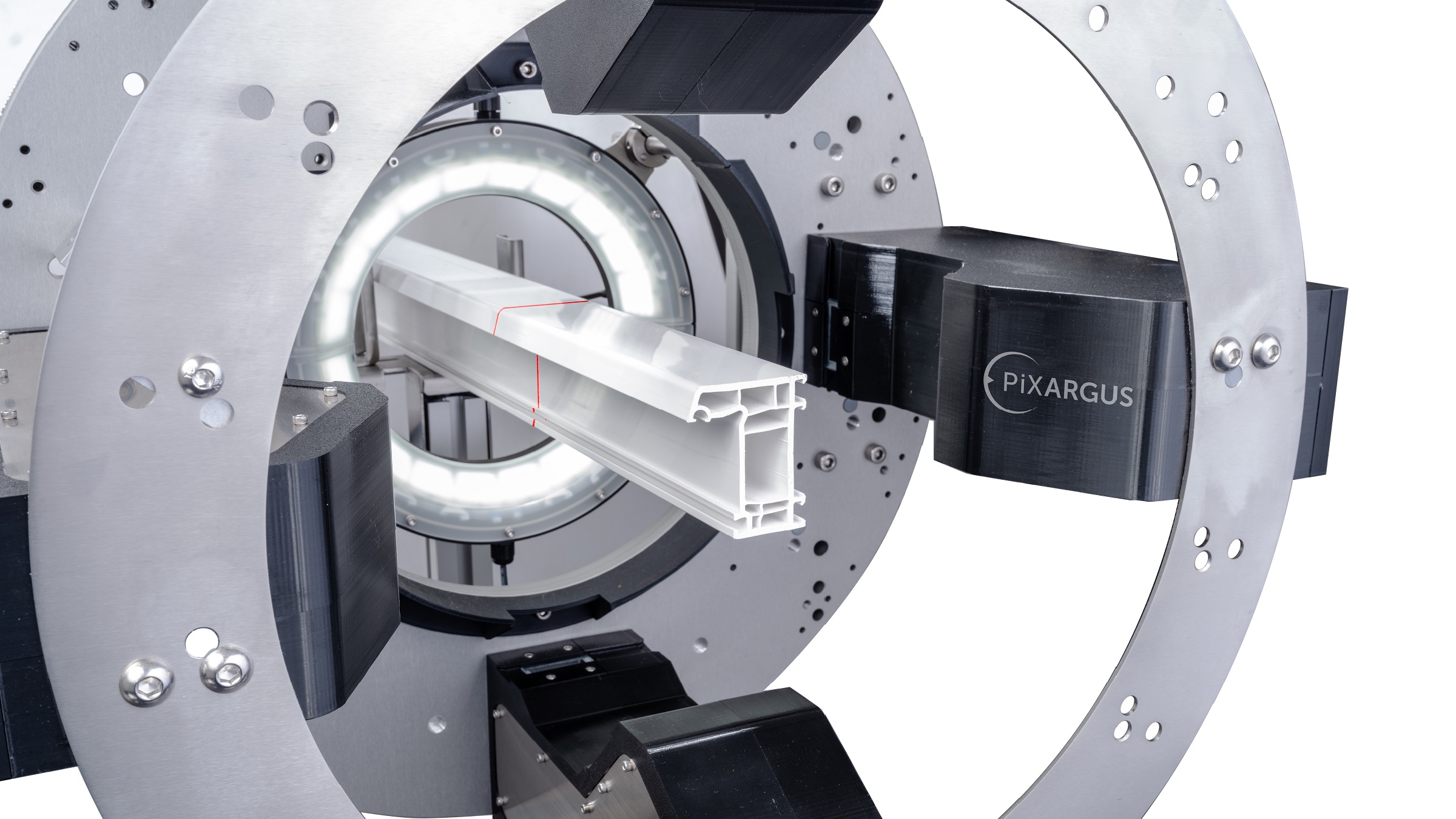

The ProfilControl 7 PlastX sensor head has been stripped to its essentials: it no longer uses a housing or hinged cover, allowing operators to monitor inspections directly without opening the head. “This saves time and simplifies handling,” says Frohn.

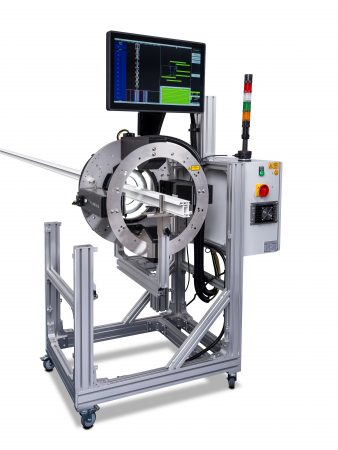

Its open sensor plate features a predefined hole pattern for flexible camera placement. Depending on the complexity of the profile, the system can be expanded from four to six—or more—cameras. Combined with a new LED illumination concept, the sensor head produces homogeneous lighting while the ProfilControl software filters out external light interference. Standard system components include an external multi-touch monitor, mobile support frame, and encoder.

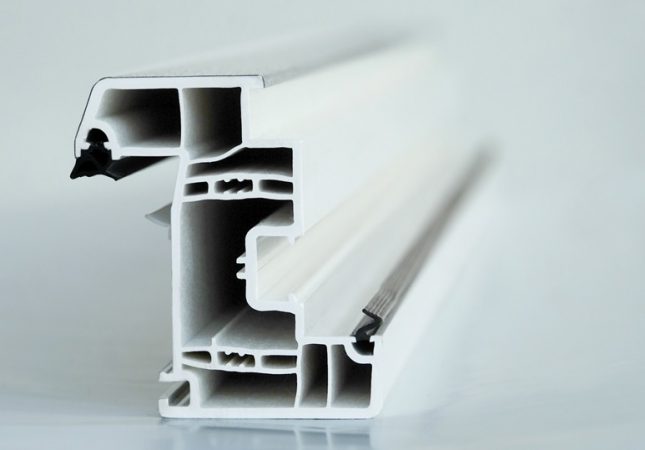

Grooves are subtle but can extend over long profile sections, often going unnoticed until too late. This is particularly critical in window profile production, where roughly 40% of profiles are laminated with protective foil directly after extrusion, making surface defects invisible post-lamination. The groove detection module in ProfilControl 7 PlastX checks surface quality before lamination, identifying defects early and reducing scrap and production costs.
