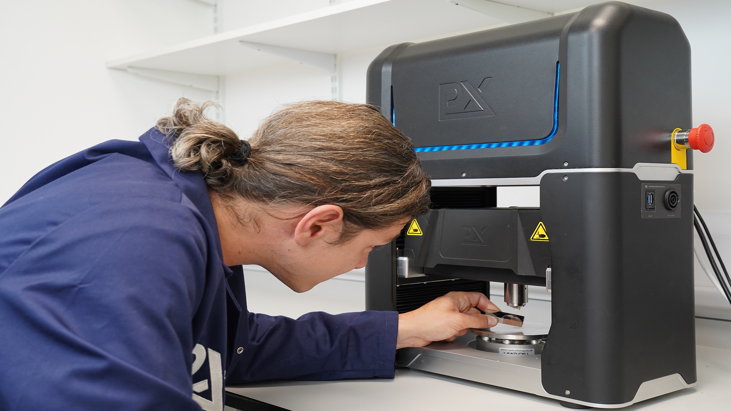

Plastometrex will contribute its Profilometry-based Indentation Plastometry (PIP) technology, delivered through the PLX-Benchtop system. PIP is a physics-based approach that extracts stress-strain curves from indentation test data using an inverse finite element method. It provides faster, lower-cost, and richer evaluations of mechanical properties than destructive tensile testing. Unlike tensile testing, it can also be performed directly on parts or samples as small as 1.5 x 1.5 x 0.75 mm and at finer resolution.

- Within-build variation: detecting property changes through the height of an AM build that tensile testing often misses.
- Build-to-build variation: identifying differences between builds more rapidly and affordably.
- Equivalency demonstrations: proving alignment with tensile results across a range of alloys produced via laser powder bed fusion.
By enabling rapid, non-destructive validation of part performance, PIP makes it possible to compare and qualify parts at the speed digital supply chains demand – an essential capability for ensuring availability in critical defence programmes. Work on these elements is expected to begin in early November.
