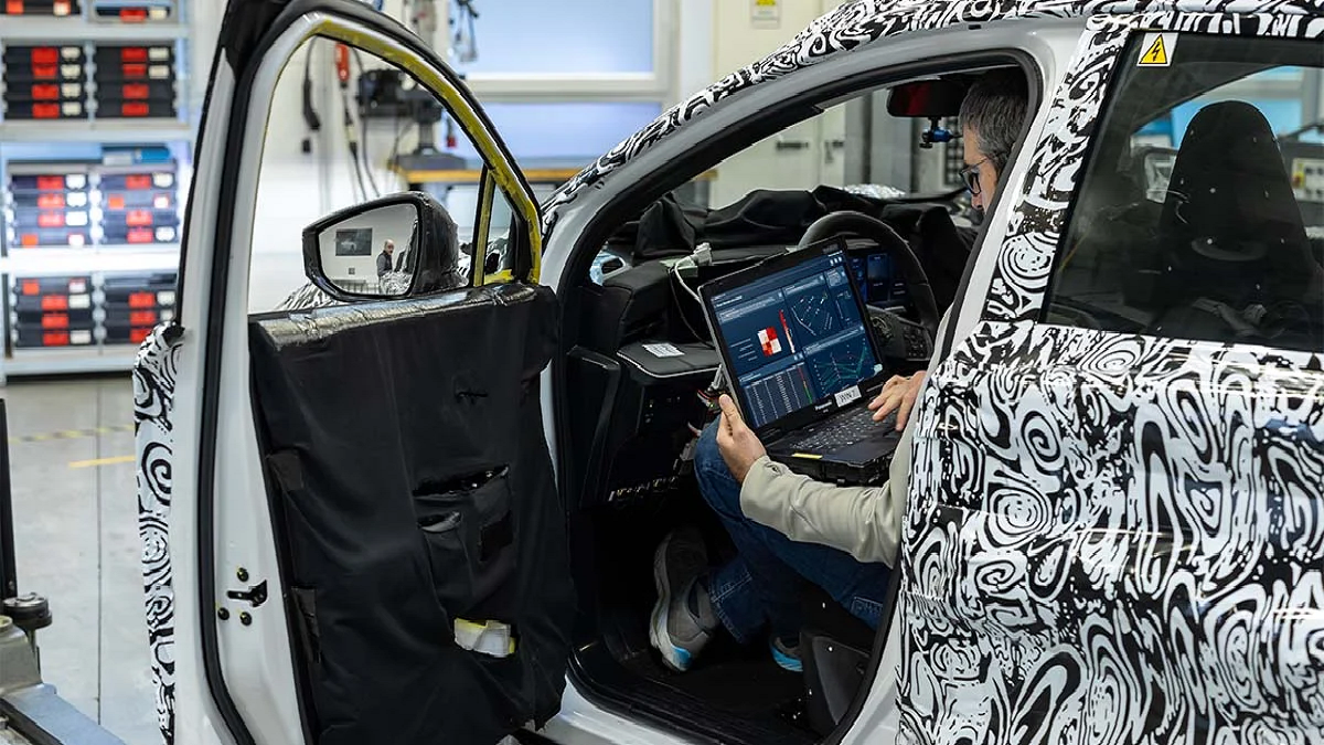

First used to validate testing on the new, Sunderland, UK built Nissan LEAF electric vehicle, Monolith’s AI technology will be applied to more tests for Nissan’s future range of models in Europe.
Using more than 90 years of vehicle testing data, engineers at Nissan Technical Centre Europe will use Monolith’s AI technology to accurately predict the results of physical tests. This reduces the reliance on physical prototypes, streamlines the development process and allows engineers to focus on hands-on problem solving and decision making.
 The decision to extend the partnership follows the successful collaboration between Nissan and Monolith using AI to test the performance of bolt joints in vehicle chassis. The AI technology recommended the optimal torque range for bolts to be tightened and reliably prioritised additional tests for engineers to carry out. This resulted in an overall 17% reduction in physical testing compared to the non-AI process. Applying the same approach across the development of all Nissan’s European vehicle range could cut testing time by half.
