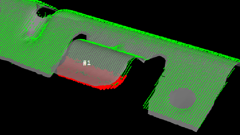

Score Visualization for Shape Matching
With HALCON 25.11, Score Visualization for Shape Matching increases transparency when setting up applications. Instead of only returning an overall score, it shows how different model contours contribute. Color-coded bins highlight which areas match well and which couldn’t be found, e.g., due to shadows or unwanted textures. This feedback helps refine models and optimize applications. The feature also supports advanced robotics scenarios, such as analyzing which object in a stack is least covered.
