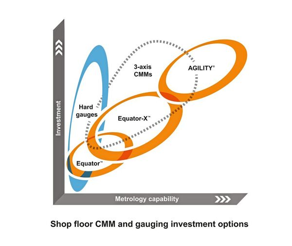

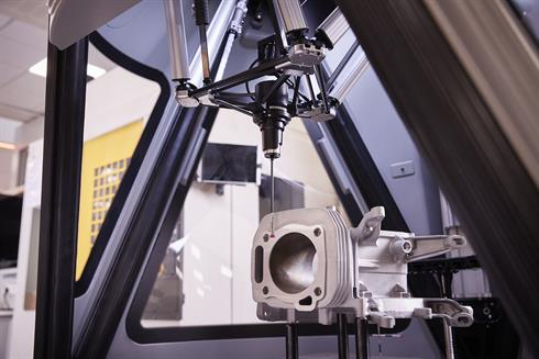

Renishaw Shop Floor Inspection Solutions for Faster Cycles

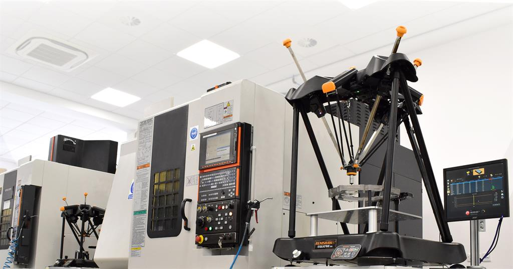

For high volumes of similar parts, the Equator gauge functions as a reprogrammable comparator that rapidly verifies critical features. Once calibrated against a master part measured on a CMM, the Equator system delivers fast results at scanning speeds up to 250 mm/s, with automatic prompts to remaster when ambient temperature shifts exceed 2 °C. The platform is well suited to long runs, robot loading and single-feature checks, and can be top-mounted to minimise footprint and integrate with automated handling cells.

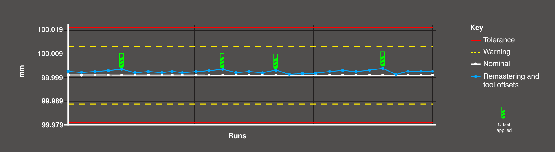

Intelligent Process Control (IPC) Software computes tool offset corrections

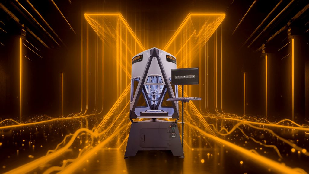

Equator-X Dual-Method Gauge
The new Equator-X gauge extends the Equator gauging concept by offering two operating modes. In Compare mode, it delivers comparator-style speed and repeatability with an even stiffer structure for higher acceleration. In Absolute mode, it measures like a CMM without the master-compare stage, enabling rapid inspection for one-offs or high-mix production. An innovative carbon-fibre hexapod drive and measurement architecture provides exceptional rigidity under high g-forces, maintaining accuracy while achieving remarkable inspection speeds — up to 250 mm/s and as much as 50 times the surface-scan rate of traditional 3-axis CMMs.

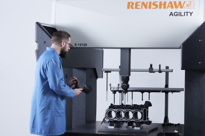

AGILITY S Shop Floor CMMs with REVO 5-axis Measurement
When flexibility and breadth of capability are paramount, the AGILITY S range of co-ordinate measuring machines combines a robust shop floor CMM platform with REVO 5-axis technology. The system is designed for high-performance scanning and automatic switching between contact and non-contact sensors, including surface finish measurement. Available machine sizes span from X 700 mm, Y 900 mm, Z 600 mm to X 2,000 mm, Y 4,000 mm, Z 1,600 mm, supporting a wide spectrum of part envelopes.
The REVO system enables infinite positioning with synchronised 5-axis motion, dramatically reducing repositioning overheads and enabling continuous surface data acquisition. Multi-sensor and stylus change capability provide the right tool for each feature with reach up to 800 mm for deep-cavity or large-form parts. In production environments, the combination of 5-axis motion and linear motors has demonstrated low maintenance requirements and high uptime, supporting sustained throughput with immediate feedback to up-stream CNC operations.

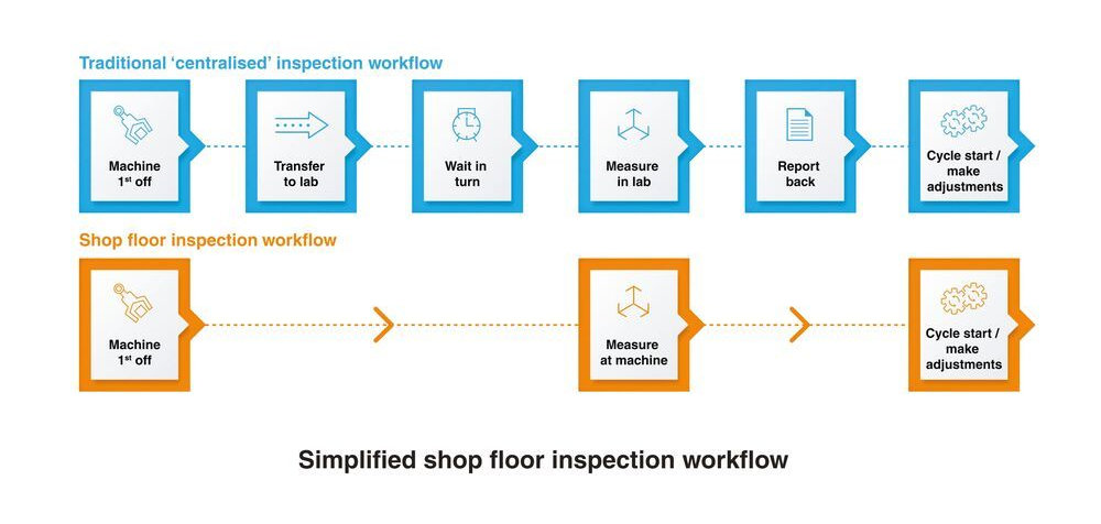

From Centralised Inspection to Near-Machine Measurement
Migrating from a centralised inspection room to shop floor systems removes non-productive time: there is no transfer queue, no waiting for parts to stabilise to 20 °C and no backlog at a single metrology resource. Results are available sooner, enabling faster offset decisions and preventing the accumulation of rework at downstream stages.

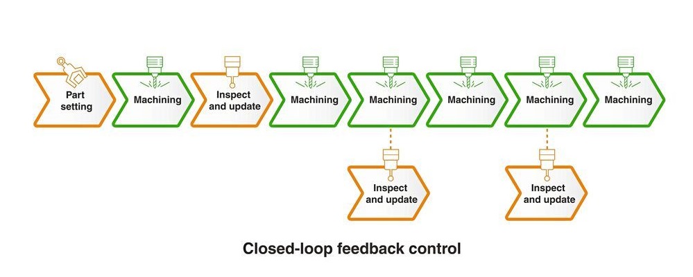

Closing the Loop: Intelligent Process Control
Inspection adds cost when treated as a standalone activity. Its true value emerges when measurement feeds the process. By comparing empirical part data to nominal tolerances, systems compute tool offset corrections and convey them to the CNC controller in real time. Subsequent parts move closer to target, and periodic updates counter gradual drift from tool wear and thermal cycling. This closed-loop approach, often referred to as intelligent process control, supports tighter capability, improves statistical stability, and prevents out-of-tolerance conditions before they occur.
In mature lines with proven capability, near-machine measurement may primarily confirm tool integrity and monitor daily thermal effects, maintaining compliance without measuring every feature on every part.
