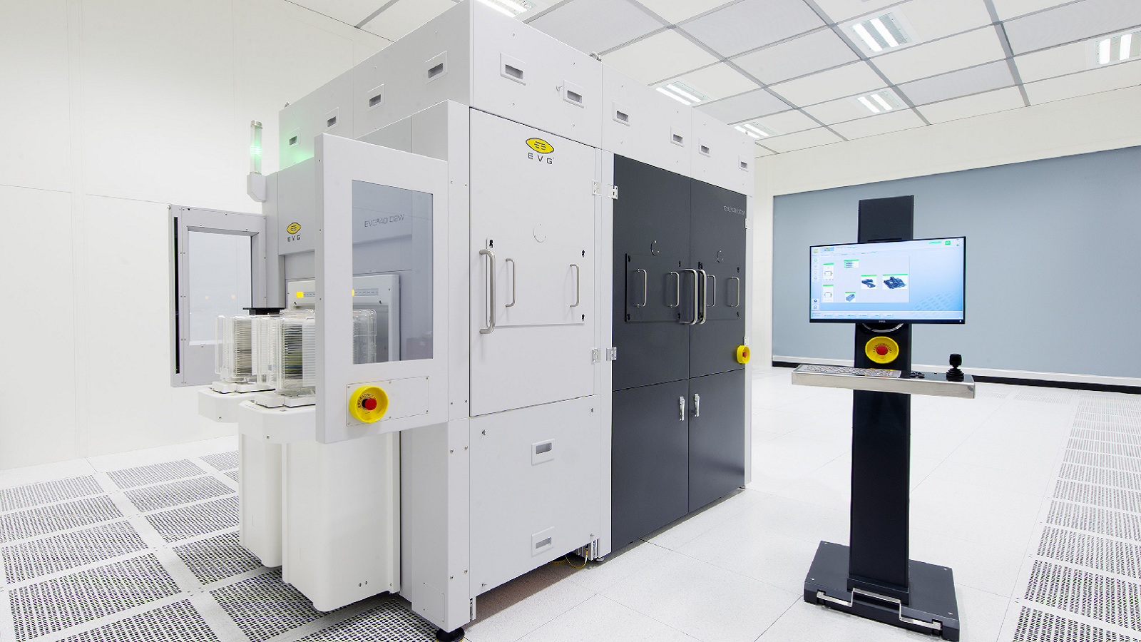

EV Group (EVG), a provider of innovative process solutions and expertise serving leading-edge and future semiconductor designs and chip integration schemes, recently unveiled the EVG40 D2W – the first dedicated die-to-wafer overlay metrology platform to deliver 100 percent die overlay measurement on 300-mm wafers at high precision and speeds needed for production environments. With up to 15X higher throughput than EVG’s industry benchmark EVG40 NT2 system designed for hybrid wafer bonding metrology, the new EVG40 D2W enables chipmakers to verify die placement accuracy and take rapid corrective action, improving process control and yield in high-volume manufacturing (HVM).
The EVG40 D2W can be used for any D2W bonding application, including chiplet integration, high-bandwidth memory (HBM) stacks, and 3D system on chip (SoC) integration processes, which enable high-performance devices for artificial intelligence (AI), high-performance computing (HPC), data centers and other applications. Multiple EVG40 D2W systems have already been installed at customer sites and are being used in HVM production services.

The EVG40 D2W has several hardware and software enhancements to achieve precise 100 percent overlay measurements across all dies on a 300-mm wafer without impacting throughput:
- Enhanced throughput via dual-layer measurement of alignment targets on both the die and the base wafer in a single pass
- High-speed precision from a new stage design, which ensures synchronization between image capture and stage movement
- Consistent accuracy thanks to a modified light source, which maintains proper levels of illumination for precise measurements
- High-quality image capture enabled by large focal offset, ensuring high signal-to-noise ratio when the focal plane of alignment targets differs between base and top chiplets

- Measures up to 2800 overlay measurement points across the wafer in just four minutes, delivering 100 percent die positioning feedback without sacrificing throughput
- Measurement precision supports requirements for leading-edge D2W bonding applications
- Uses an advanced model to calculate placement, distortion, rotation and run-out variation for each die
- Feeds measurement results back to the fab’s host system for analysis, enabling optimization of D2W overlay and bonding process for future wafer runs
- Can be used alongside any third-party D2W bonding system to ensure the highest possible level of quality control
